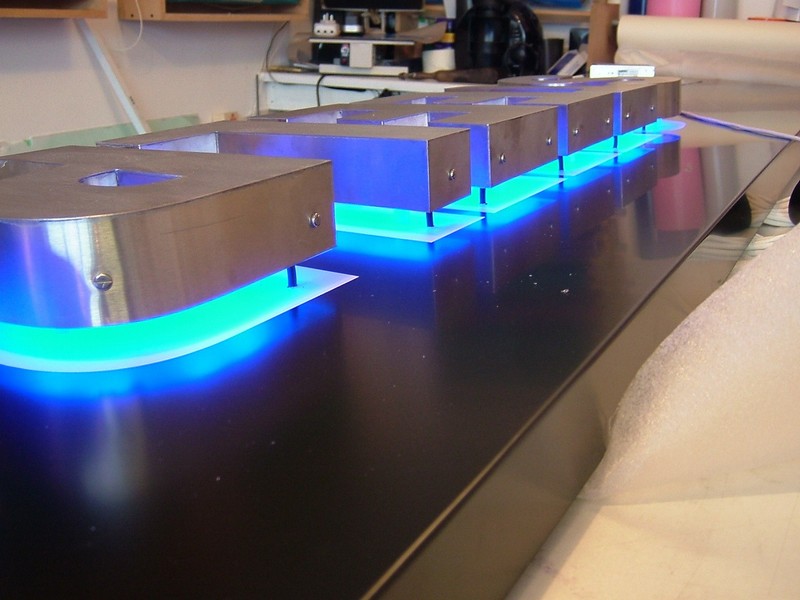

  • Sam Armstrong
    October 23, 2012 at 1:56 pm
    black sign tray with blue halo illumination.
  • Sam Armstrong
    October 23, 2012 at 2:04 pm
    The other option is of course to try and persuade them into a sign tray mounted to the wall, painted to a lighter colour, or a tray painted black and do as I have shown in photos this afternoon (or vinyl as you have suggested in your posting).

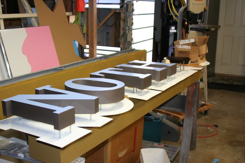

  • Richard Urquhart
    October 24, 2012 at 11:14 am
    we have done many and know the best illumination is using a white tray however never as easy as that, we lay down a white matt vinyl and works well
  • Richard Urquhart
    October 24, 2012 at 11:15 am
    and this one,

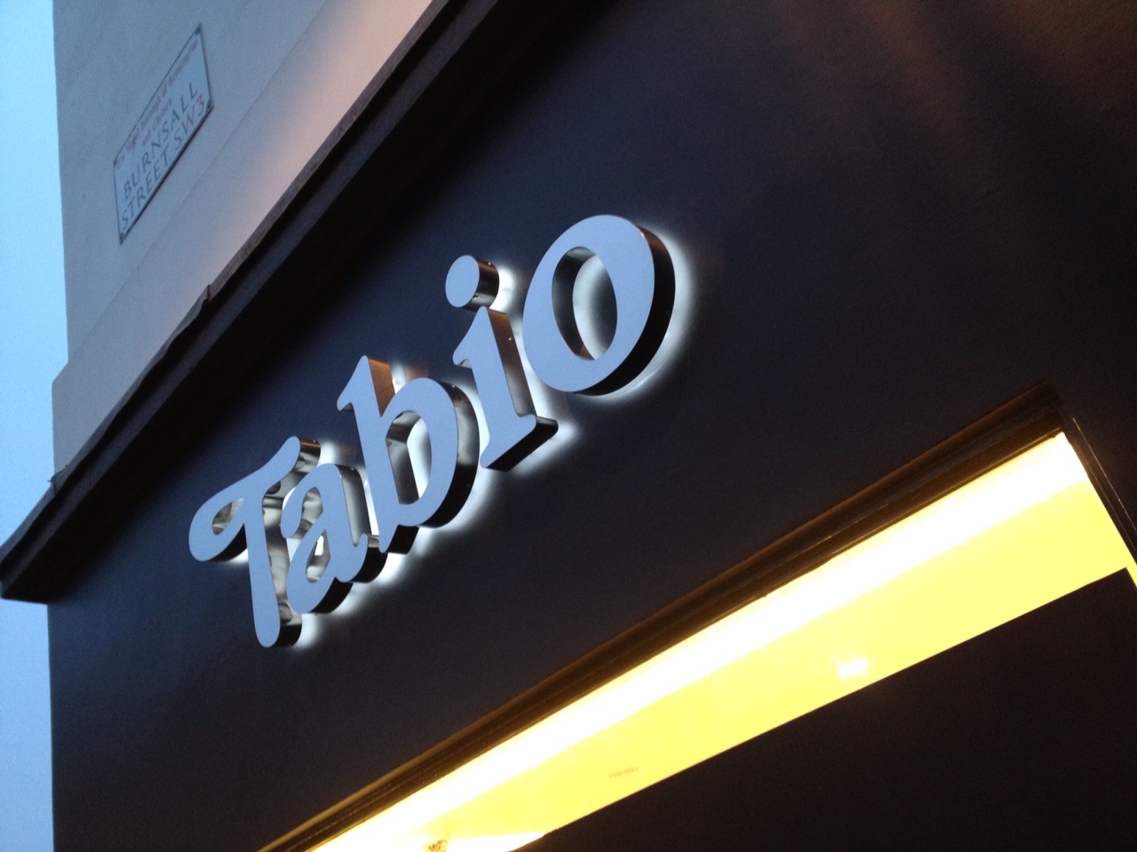

  • Martin Cole
    November 26, 2012 at 3:08 pm
    quote Richard Urquhart:
    Just reading the comments after mine and I can see I was missing the point!
    Sorry Marting I didn’t see the rendered wall part, until now! its been a hard few sleep less weeks !
    LOL…I read your replies thinking…he hasn’t read the thread 😀
    Anyway..all fitted now and all looked pretty good. Had to fit two sets.
    Thanks for all the replies….even yours Rich 😀

    November 26, 2012 at 3:27 pm
    Thats looking nice mate. I’m working on one at the moment so will post when complete, the halo looks great, nice and soft.
  • Martin Cole
    November 26, 2012 at 3:45 pm
    Yeah, halo effect was nice Rich. Face on.. it lost it a bit where the back ground was black, but over all pretty good.
