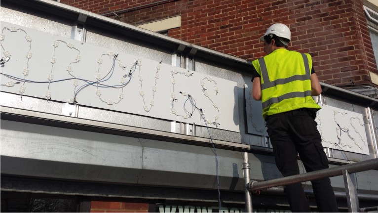

    It depends on what type of LEDs you use, we use some for backlighting trays with lettering taken out like this, sign is 120mm deep, LEDs are about 60mm apart, end result is a very bright sign.!!
