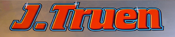

    I had 7 of these to do in one day each with six layers
    It’s worth it in the end though

    Very nice :clap3: all vinyl or is some of it printed?
  • Paul Rollason
    January 20, 2005 at 4:33 pm
    All vinyl
    using some stevo trickery
    Paul R(Mackerelbus Design)

    Looks great Paul – what colours were used to build up this design?
  • Paul Rollason
    January 20, 2005 at 5:29 pm
    Hi John
    First the black then the red and the blue pinstripe
    Then orange for the high lights, Burgundy for the low lights and finally
    white for the hotspots.

    On what surface will it be applied please (?)
  • Paul Rollason
    January 20, 2005 at 7:05 pm
    Hi Andy
    The one shown is applied to a sheet of stainless steal
    But we have applied this design to the clients vehicle to banners, aluminium site boards and t-shirts.

    Nice work Paul. If I can ask a question though, Did you cut all the layers at the same size, or add the high/ low lights and sparkles individually.
    Reason i ask is if you cut all the same its a lot of vinyl, if you added some elements separatlely, less vinyl but more time to do, if you see what I mean,
  • Paul Rollason
    January 20, 2005 at 7:20 pm
    I think I know what you mean.
    most of the high/lowlights (the orange and burgandy) were cut in their actual positions because although this uses a bit more vinyl it does save time and as vinyl is relativly inexpensive it was more economical to do it that way in the end.
    The white dots and sparkles were cut all bunched up together and put on one at a time.

    It was worth it matey. I know some people will say (adopts squeaky, patronising voice) “Why didn’t you print them?” but you just get a much better depth of colour by using vinyls I think. Nice one.

    That looks cracking Paul, i thought printed first off as well,
    but how do u price up to bring it in line with the printed stuff? or is it a case of with this customer price is no option as they want a great looking logo?
    i normally do price per meter used but that would cost way to much for that?
  • Paul Rollason
    January 21, 2005 at 8:45 am
    Thanks for all your encouraging comments
    Mort, I don’t think I can compete on price with a printed copy.
    But, I don’t have a printer and this way i can do it all in house.
    It’s all my own work (with a little help from Stevo)
    The colours are more vibrant and the edges are sharper.
    I enjoy doing these once in a while and I’m sure it’s going to bring in more work.
    However
    It remains to be seen if I still feel the same way when I can afford a Cadet!
    January 21, 2005 at 9:38 am
    Paul. Just Excellent! Did you do this with clear app tape? Would have had a degree of difficulty using paper I’d think…..
    I have a Roland Printer/cutter but I still opt for tape on something like this anyway. As Andy says, colour is more vibrant and will last heaps longer. Really depends on whether the customer is looking really long term, or would be happy with a printed ‘copy’.
    Mort, I charge per sq metre for each colour. The highlight colours I use my off cuts for (never throw any large off ciuts out for that reason). That way the tape has already been paid for by the client that the off cut was originally from, so it is sort of like double dipping 😕
    Cheers again. Thanks for sharing this paul.
  • Paul Goodwin
    January 21, 2005 at 9:42 am
    Thats what i do as well ( i have a huge off cut bin now ) i just wasn’t sure if that would be the right approach on something like this, to help keep in line with teh printed stuff,
    but hey if they want the sign they will pay for it 🙂
