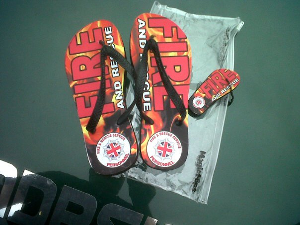

    Chris, i just went over to a ricoh with Sublijet inks…. when I got the colour profiles sorted (info on sawgrass web site) it’s great… how about these flip flops I just printed……. It’s gel ink too so no dry up problems if you dont use it for a few weeks…..
    Awesome peice of kit!
