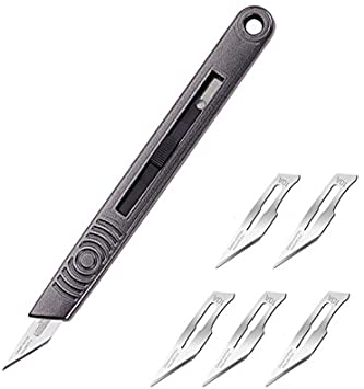

    Swan Morton retractable fitted with 10a blade is what I normally use.
    Retractable Stanley for some heavier cutting.

    A dozen or so S&M #3’s, with 10A blades for the majority. Olfa 9mm with ABB-50 black blades in my back pocket, particularly good for cutting work off the little graphtec, and general opening of stuff. Not so good when pulling wallet out in the pub (remember pubs?). I find the Olfa blades don’t give the same precise control as the scalpel.
    Oh, and blunty boxes placed all around the workshop.
    Just need a decent holder for the scalpels.

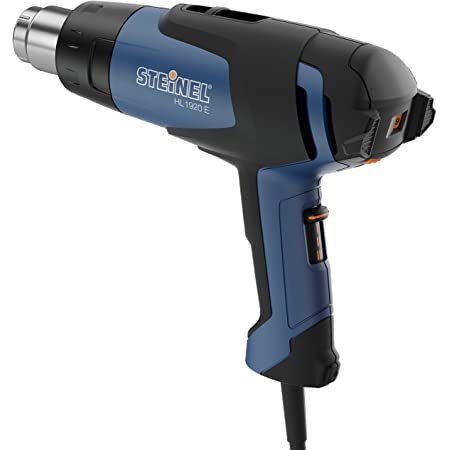

    @KevinMahoney
    Thanks Kevin. I looked that gun up and it comes in at about £90.00 is it really worth that?
    What does it do different that makes you want to stick with that one?
    • Kevin Mahoney
      March 4, 2021 at 11:59 am
      I’ve found during a wrap installation, some of the cheaper ones have burned out quite quickly after extended periods of post heating, even some of the heftier 2 kilowatt ones. The steinel ones with the laser attachment have never let me down. Not worth the money if you’re not wrapping on a regular basis though, a £30 bosch one is fine for day to day use

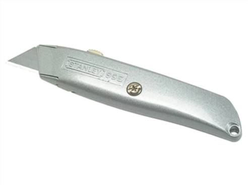

    I think a “retractable” ANY knife has to be better than a permanently open knife!
    Safety-first and all that…
    Personally, I cant see by the simplicity of an Olfa. from how it feels in your hand to how easy a blade is to change. Plus it holds multiple blades at a time.
    Heat Gun wise, I think it depends on what you do. if your a sign maker then most guns OK. the cheaper tend to burn out or break the fastest. If you are using a heat gun all day every day i would certainly look and the more solid guns like Steinel.
    For me, a Bosch does the trick just fine. had my gun ages now and still going strong.

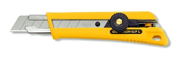

    Finally for the ignorant work like scoring Skybond for snapping etc, it’s a Olfa NOL-1. It takes an 18mm snap-off blade which again is handy, just don’t do a “Robert” and stick it into your pocket with the blade out!

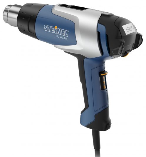

    I’m with Kevin with the Steinel heat guns especially for post-heating due to the thermometer attachment, at 90 quid a pop though you need to make sure you don’t drop them as the ceramic inside tends to break and get stuck in the fan causing it to overheat and burn out (ask me how I know!)
    We’ve got a couple of Amazon specials at £25 each too that have been dropped multiple times and seem indestructible.
    Hard to beat for the price.
