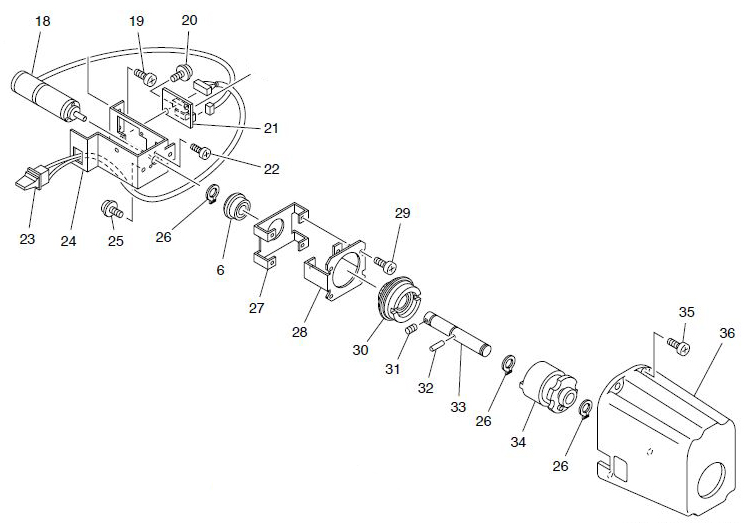

    Anyway, it’s the white bit that sticks out of the end of the motor (with the tension adjuster) and the two bits of friction material inside of it.

    The pump pipe is Tygon tubing. Personally, I’d just buy a genuine Mimaki pump and be done with it. Some of the older machines have slightly weaker pump motors and can’t drive the thicker Tygon stuff.
    Here’s a couple of pics of the take up assembly for you to identify. Let me know what you want and your details and I’ll stick it in the post…
