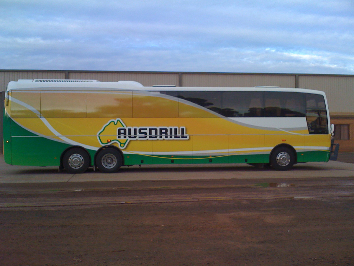

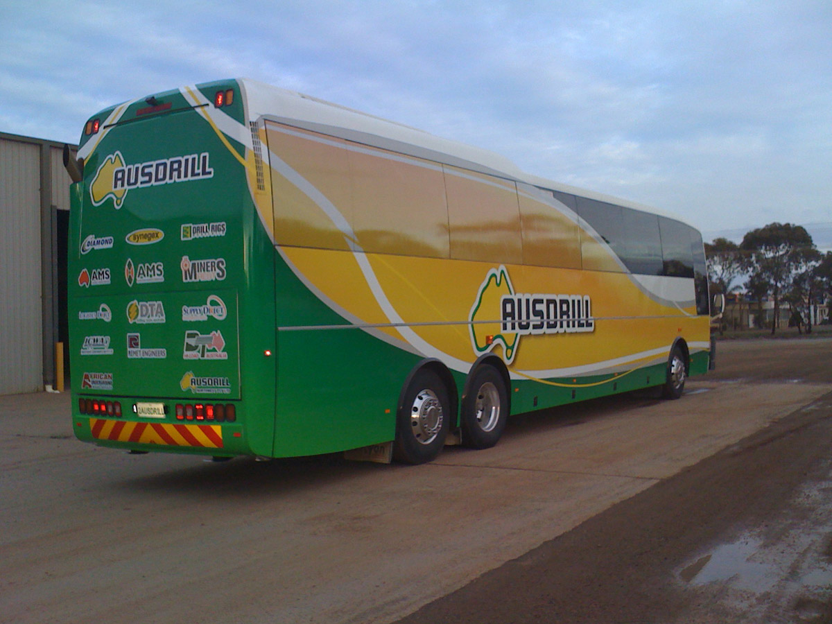

    Just some pics of a bus wrap we did a little while ago. We wanted to try make it look like paint so there are only 2 joins on the whole project (on the rear).
    Something a bit different to our usual mining work!

    what vinyl did you use here, and how long approx did it take to fit?

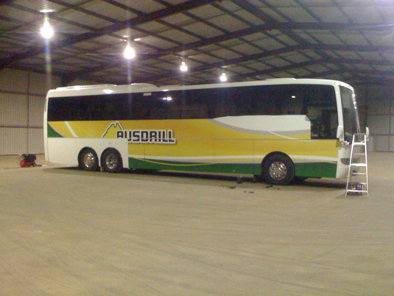

    Rob, I used 3M 180CV3 with 8518 Lam, it took 7 full on days for me to install it by myself including stripping all door handles, lights, etc. I printed each door separately so there was enough to wrap around the edges of the doors – the only real difficult part of was the 12.4m x 600mm panel that runs the length of the bus!
