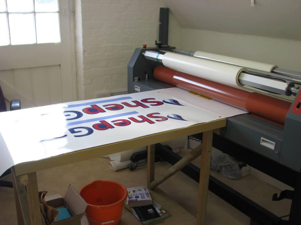

    I have a jetmounter bought from Peter Norm, I have been very pleased with it, you certainly dont need a carrier board.
    I have built a table 1mm higher than the platten of the laminator so when i have prints to laminate I just wheel the table into position and butt it up to the laminator – this is great to help align the print as the edge of the table is 90 deg to the printer then just feed it in generally i do prints up to about 4m long with no hassle

    Thanks for posting, if you had a 4mtr print to laminate I assume you have it rolled up and at the end furthest away from the laminator and using the foot pedal it will gradually unroll as its feeding through.
    I notice you dont have much room behind the laminator, do you just let it fall behind as it passes through.

    Hi Bob you can fold or roll it – sometimes i just let it hang off the back of the table, i tend to feed it through on auto rather than foot pedal and yes it just drops out of the back due to space otherwise i would have a table behind slightly lower than the laminator platten by a couple of mm so the graphic slides off easily
