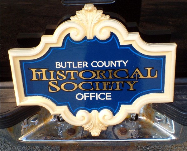

    All I can find as an example is gilding on Alumalite for last year’s Letterville Panel Swap.
    Not my best work by any means.
    The church folks might complaint that the DiBond is much thinner than the regular wood.
    If gilding with a mask, I always cut an additional thin outline but don’t weed it. I apply the size, then take off the outline. This keeps the lettering from getting a "lip".
    I’ve been liking that "Crocodile" gold, I think it’s from Oz.
    Also trying to show something I gilded with a mask that ghosted on the background. It’s a formed HDU Caravagio blank.
    It probably won’t show up…you know how ghosts can be.

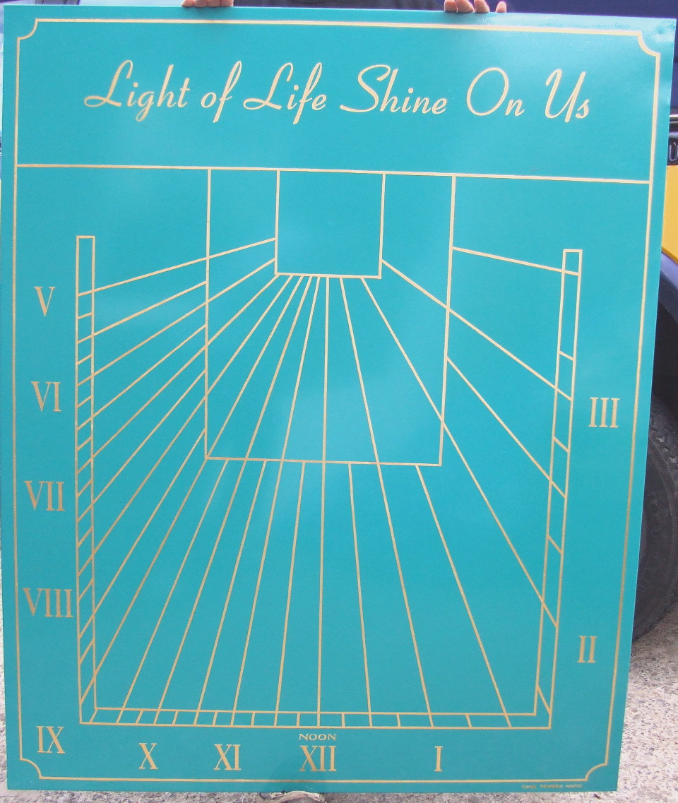

    You should be OK using Dibond, using a size with a longer ‘open time’ will be better if you have alot to gild and will also give a better lustre.
    You could use some hardwood framing to ‘beef-up’ the sign
    http://www.jagsignsupplies.com/aqshop/catalogue.php?id=360
    I do quite a few sundials which are goldleaf but on a painted brass and these weather fine.
