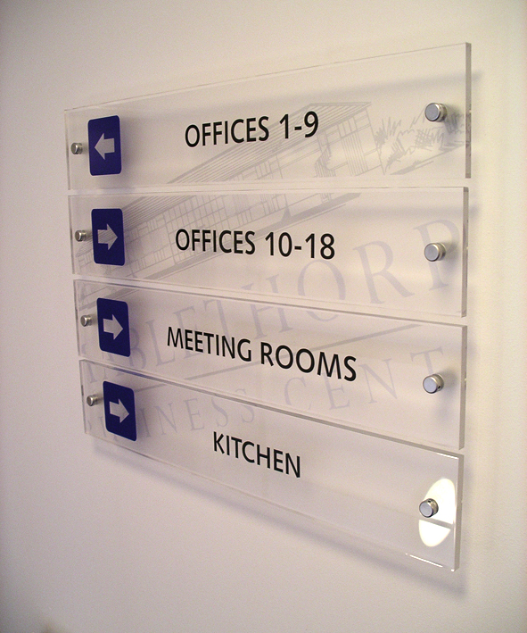

Activity Feed › Forums › Sign Making Discussions › Gallery › Internal Acrylics – Printed Etch Logo Gallery Internal Acrylics – Printed Etch Logo Posted by Pryam Carter on January 27, 2007 at 8:25 pm I enjoy doing this kind of work, we don’t get it much so thats why i like it i guess. Attachments: Pryam Carter replied 17 years, 3 months ago 4 Members · 4 Replies 4 Replies Russell Pavey Member January 28, 2007 at 2:56 pm That’s really nice – how do you get the tinted background in conjunction with the etch? Russ Marcella Ross Member January 28, 2007 at 4:07 pm nice work 😀 Lynn Normington Member January 28, 2007 at 4:49 pm nice and clean looking Pryam like you say it’s nice to do this sort of work. Lynn Pryam Carter Member January 29, 2007 at 1:52 pm It’s a frosted / dusted vinyl that you can digitally print onto. I printed reverse and then applied it to the rear of all the acrylic pieces. Log In to Reply Log in to reply. Public All Members My Connections Only Me PublicAll MembersMy ConnectionsOnly Me Public All Members My Connections Only Me Log In to Reply Start of Discussion 0 of 0 replies June 2018 Now
