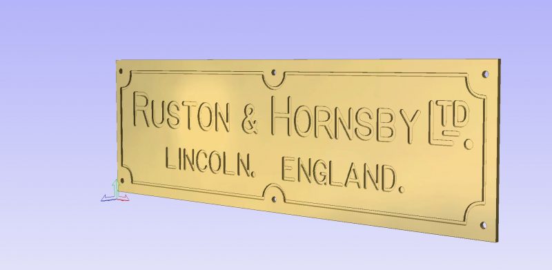

    In the process of getting an engraved plate done for a 100 year old Steam Roller, its about 350 wide by 130 high to give it some scale. Depth of engraving is 1.5mm.

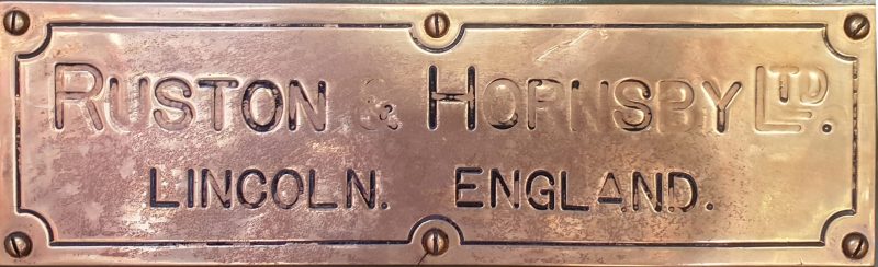

    The old plate is being replaced because some of the characters can hardly be seen due to all the polishing it has put up with over its 100 year life. (2nd Pic)

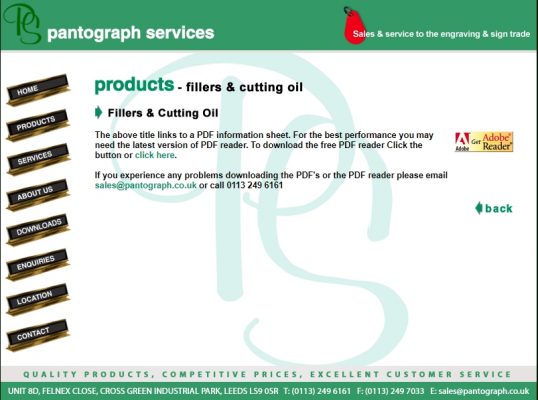

    If you want to keep it authentic then perhaps use hard wax. 1.5mm deep is fairly deep for that size of the lettering so should stand up fairly well to polishing. Pantograph Services sell it. pantograph.co.uk
    See attached PDF Download below
