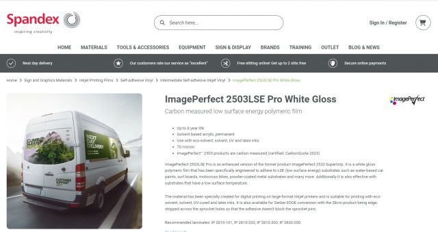

Posted by Pane Talev on 22 March 2024 at 09:51ImagePerfect 2503LSE Pro
White Gloss Polymeric Vinyl LSE (low surface energy)
Wet application, OK or NOT OK for this vinyl?
Being extra sticky, why would you “compromise” the adhesive?
Curious to see hear your opinions.
