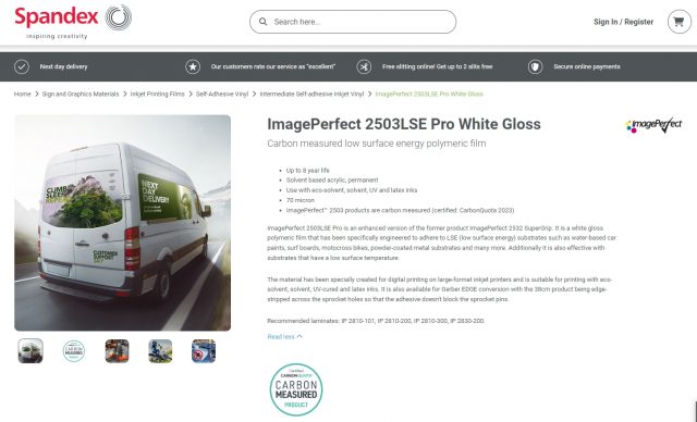

Posted by Pane Talev on 4 March 2024 at 18:23ImagePerfect 2503LSE Pro White Gloss
White Gloss Polymeric Vinyl LSE (low surface energy)
A bigger brand alternative, suggestion, please?

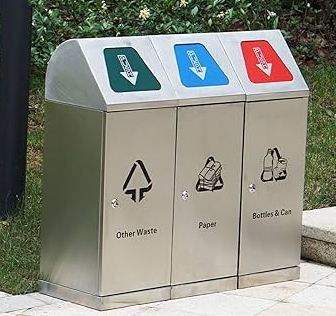

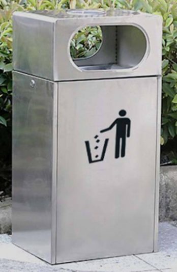

The client is using this vinyl for stickers that are applied to stainless steel rubbish bins.
Will Metamark MD5 work here? (NOT a low surface energy)Does stainless steel require a low surface energy vinyl sticker?

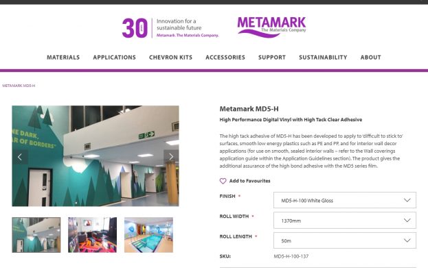

Metamark MD5H is a high-tack film, you can also get MD5HA with the air release.
I use it a lot for high tack stickers which go onto plastic bins, so will be fine for stainless steel.
I wouldn’t say SS is low energy per se, but it may have a brushed finish, in which case I would use high tack to maximise adhesion to what is microscopically a furrowed field!
https://www.metamark.co.uk -

Do you want to switch because it is failing?
Polished smooth stainless steel shouldn’t have any adhesion issues. Stainless bins aren’t something I have stuck vinyl to, but I have wrapped lots of 18-wheeler Trucks with huge chrome stainless steel Cylinder tankers on the back. and that was just using standard Oracal Polymeric.Could the bin steel be cold, corrugated and subjected to harsh cleaning methods?
The low temperature may repel adhesion on cold steel, meaning a high-grip adhesive that will bond at low temperatures, may be required. I just looked at the spec of the image perfect and that benefit is listed. If this is the case, make sure whatever alternative you switch to, also offers this in the spec.If you are printing graphics for the face, also be sure to use an “equivalent matching laminate”
it is pointless having a printed sticker on a surface that requires being cleaned with chemicals and is subject to abrasion damage, the graphic will be gone in weeks and the base film still stuck firm. -
