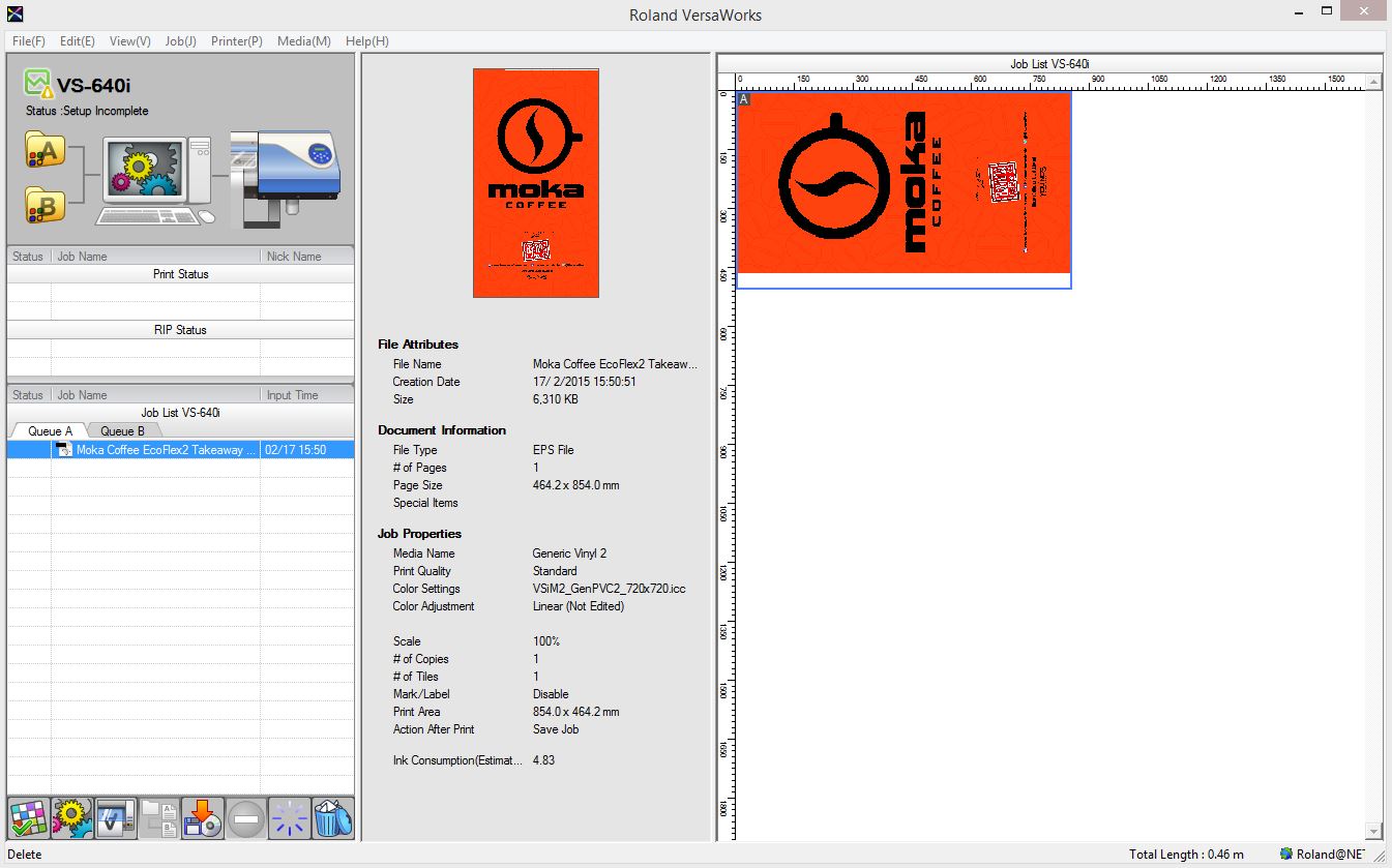

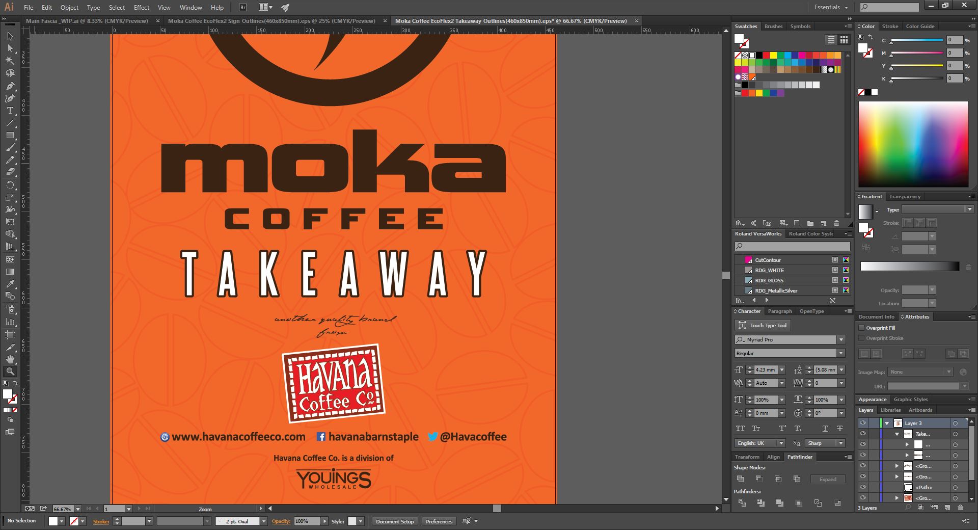

    I am trying to print some artwork but despite the artwork filling right in Illustrator and showing right in the File Manager preview it just will not show (or print) some of the lettering in Versaworks?
    I am at a complete and utter loss…

    probably find a open loop in the lettering

    Try un grouping everything and re exporting as eps, Versaworks would not always print outlines etc created by Flexi if it was just sent straight to VW so would have to un group everything and then it would print ok. Hope that makes sense

    Try to convert the text to an object in Illustrator by selecting the text, right clicking and "create outlines" option. Sometimes it won’t code correctly some fonts.
