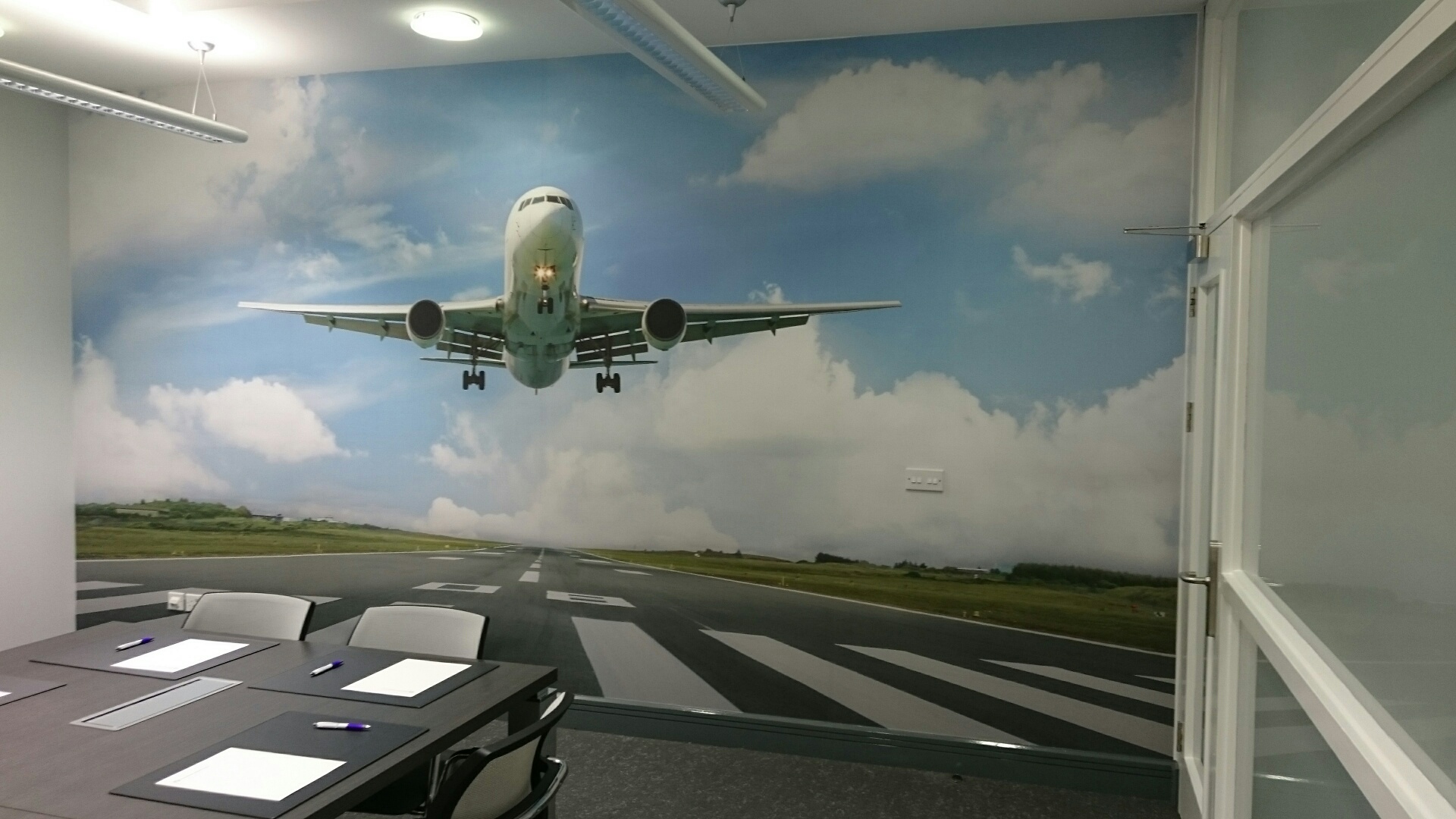

    No tunneling this time & printed a treat. Here’s the job finished & everybody happy :smiles:
  • A.Kordowski
    December 14, 2016 at 10:34 am
    Looks good, did you leave an overlap on the joins? or did you butt fit the joins?………ive done both on the graphics that I’ve fitted but i wondered what most others do?…… :thumbsup:

    Interesting question Andy, & I wasn’t sure which I would do until I actually fitted it but I ended up overlapping by about 15mm. I asked the customer if they would prefer it butt jointed & explained that there was a small possibility that it may shrink back a fraction & they were happy enough with the overlaps.
    Interestingly though, I did run into another issue. When I printed it I had been supplied with a brand new unopened 15m roll of the textile. I printed a test initially, using approx 1m & then continued to print the full graphic which was almost exactly 11m, so should have had 3m to spare. Unfortunately to my extreme surprise & annoyance the roll ran out with approx 250mm of print still left to go!!! The graphic HAD to be fitted the following morning, So I contacted the supplier who apologised profusely & immediately organised another roll to be sent out, but it would not be with me till the following day.
    So I had to print a patch on the closest thing I had to match which was a bit of matt laminated removable vinyl. I added it to the bottom of the last panel when I fitted & although it didn’t match colour exactly, it was far better than a blank white space. I explained to the customer & said I would be back next day to replace it with the correct material.
    So next day did just that & cut in the new section with a butt join which runs up with the edge of the runway you can see in the bottom right of the picture. The butt join worked ok & is indeed very neat, but I was glad that I hadn’t done it on the vertical joints for the reason that when you cut through both layers of material, inevitably you will cut into the paint/plasterboard below. Then when you have to lift the top layer to peel out the layer below it is almost impossible to do it without a small amount of the paint lifting too which could obviously be an issue as it won’t stick down properly again! So I think if I do any more I will be overlapping every time.
