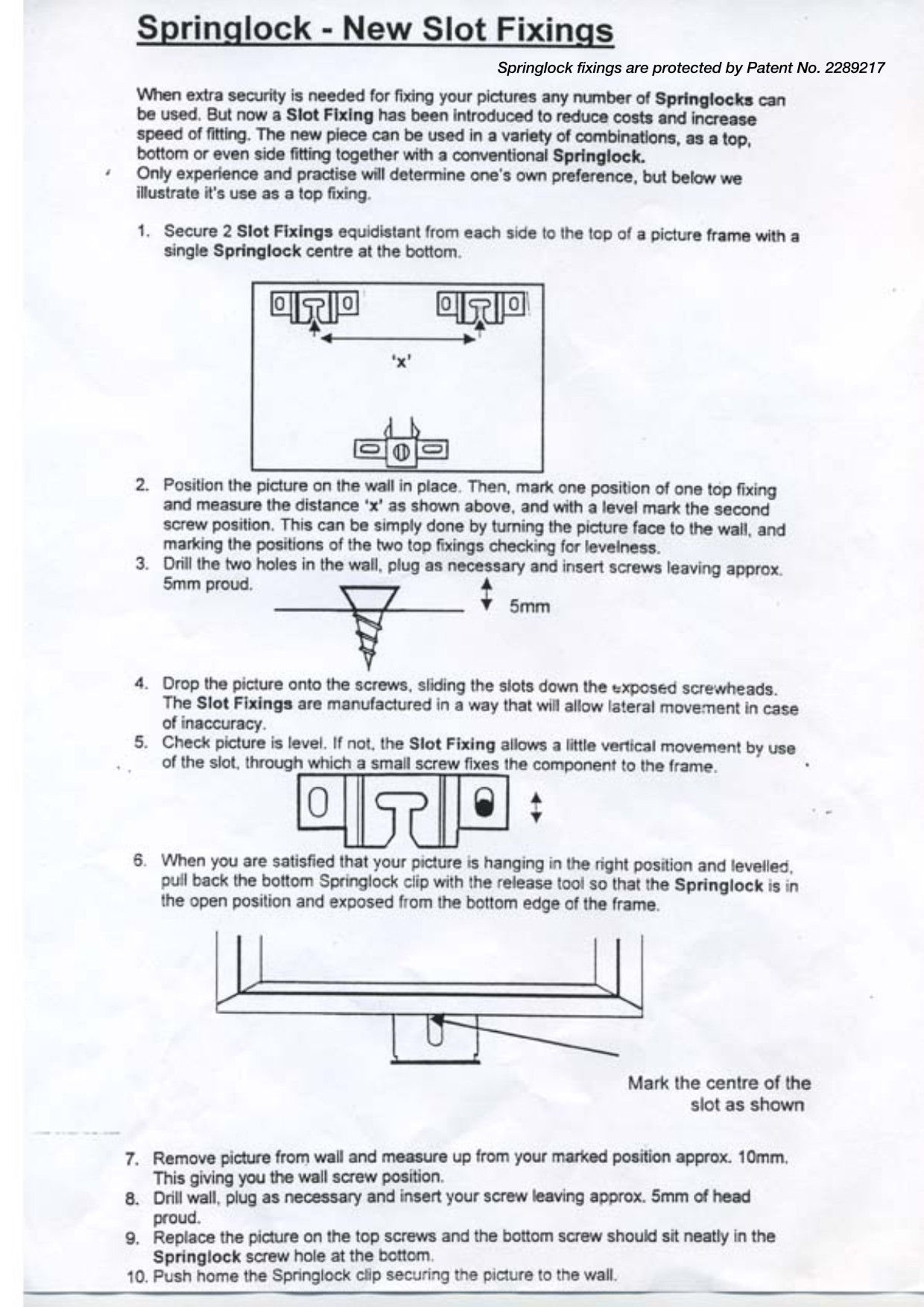

    Hi Simon, installed a few of these with security fixings.
    Fittings hold the canvas tight and have a key to remove
  • Simon Worrall
    July 23, 2014 at 8:14 am
    It might be too late for a split baton, they are already stretched onto frames which are rectangular in section. 🙄
    David thanks, I do not really trust the adhesive on those velcro thingys.
    Chris those springlocks look about right. I will see if they are available here in NZ.

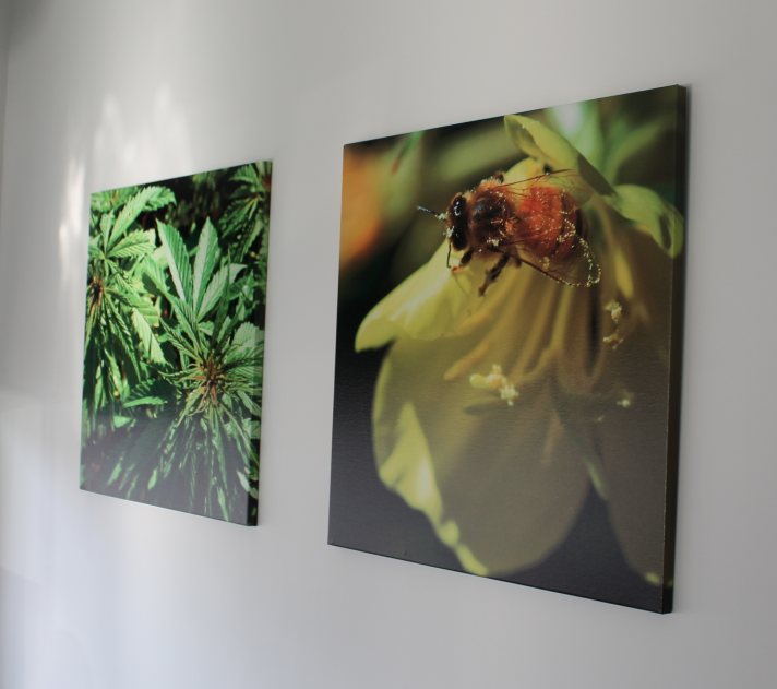

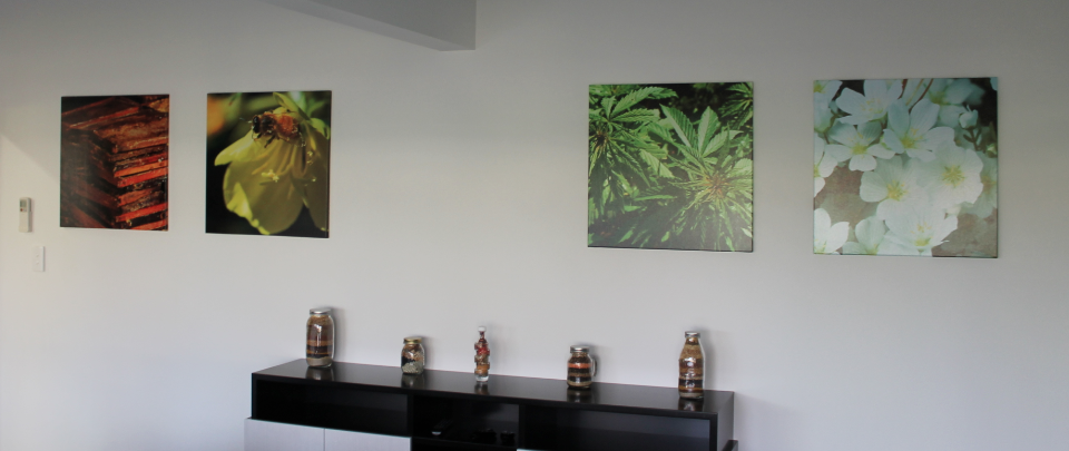

  • Simon Worrall
    August 1, 2014 at 9:11 am
    Well here are some pics.
    We cut batons, , bradded them into the wall with a compressed air gun. We hung the top frame on it with Vhb tape in between. The weight is completely held up by the baton.
