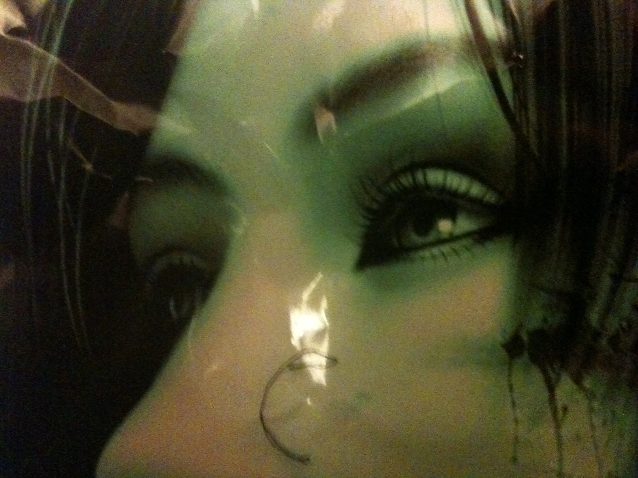

    I have a hp8000s and i desaturated an image then coloured some blood in on the image in red to match what customer want so the end result would be a black and white image with the blood in red.
    I printed the image and it came out green ????
    Please help as i need this job sorting..

    Im using Onyx Rip, the image was converted to CMYK before i imported into the rip.
    I even tried desaturating in the rip before printing but it just came out the same…
    Its so frustrating…
