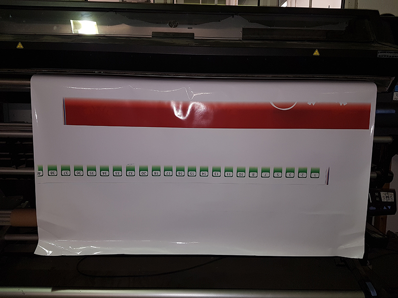

    When printing, we normally use a 1370 mm roll and the printer is capable of printing almost edge to edge, so a 1220 mm print should be achievable but we are only getting about 1180mm with print due to the printer starting some 150 mm in!
    I cannot fathom how to change this, ive tried centring, starting from the left, starting from the right, nudging the roll along on the spooler, every time it will start 150 mm in. Cant find anything relating to borders etc.
    Can anyone please help, im running Onyx 11 if it helps? No help from them as yet.
    Attached is an image of what happens, in this case the red starting from the left side, under the green started from the right?

    On printer:
    setting – substance – substance handling – right hand edge (check what’s been put into this box).
    In Onyx:
    Placement – general (check on offset has been entered & justification is centre).
    In Onyx:
    Thanks Colin, pretty much what ive fumbled my way around to doing – all be it a strange combination of things between the printer itself and Onyx but im happy its working now. Appreciate the help :thumbsup:
