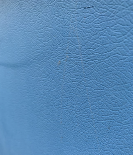

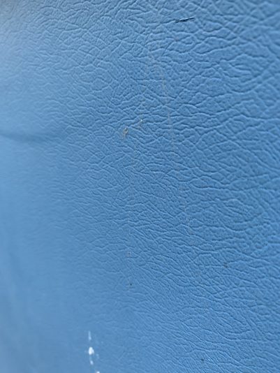

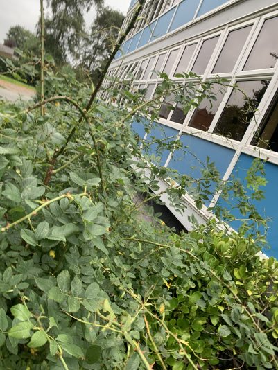

    school building with blue textured plastic needs replacing with a dark grey see pics.
    about 90 panels all apx 1620mm x 800mm each.
    There will be scaffolding all around the building so access should be ok.

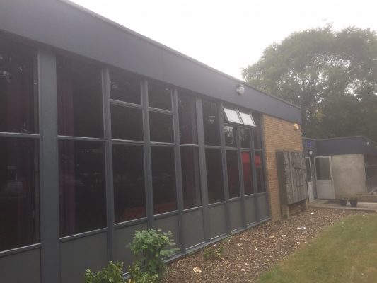

    Hi Jean. We’ve literally just finished doing a school today. 200m of panels. Each panel 3.2m x 600-800mm.
    Using a new base material over an old one causes a world of pain (since Grenfell) and anything need to be fire rated and Building Control involved. No manufacturers will give you any guarantees of anything though – even the fire rated material. No one will take any responsibility these days
    We ended up using the same panels and vinyling straight over them dry. No application tape. The entire windows in our case were replaced and we just did the facia (Avery 800 Matt grey).
    Basically you have 2 options really. Vinyl the panels in situ and put a bead of grey sealant around the edge in case of shrinkage (alternatively if you’re hands on you can remove each panel and vinyl it all to the edges – that way you won’t need to put a bead round.
    Mask up and spray (as suggested) – again you might need to put a thin sealand bead around
    Apologies for the rubbish photo (old phone with scratch screen protector on it !)

    the blue panel material is something I have used for over 25 years. it is basically a PVC coated steel sheet that is used to fabricate factories worldwide and has a UV stability of around 20 years.
    because of the type of veined surface, you will not have bother with bubbles as the veins act as air channels, so application is easy enough. however, depending on how you clean the surface and the quality of the vinyl, will determine the life because those veins also act as a micro-cavity and can hold moisture and grime over time. still, very much doable and easy to flood coat, but worth mentioning.

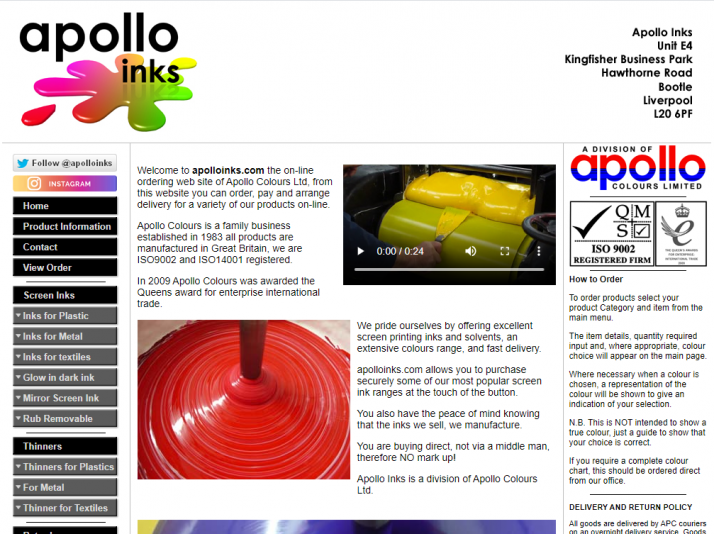

    I would seriously consider using a four-inch “short hair” roller, mask off the trim and roller it with solvent “INK” from Apolo Inks. a half can of ink and can of thinner will go a hell of a long way and will be dry in minutes. it will bond great and if you mix it to the correct consistency will take a quick single coat. i.e. (you want it runny as milk).
    http://www.apolloinks.com
