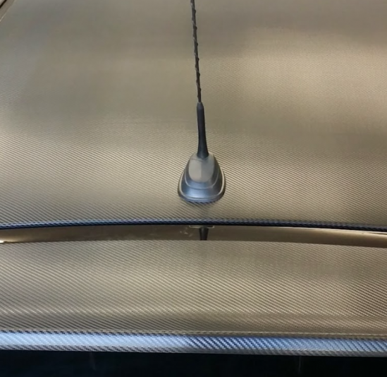

    Is it like this Simon?
    As you will already know, wrapping the headboards of high-roof top vans is a pain.
    The key is your access to this area.
    Trestles with a catwalk spanning the window are great if they are solid. Don’t use something that will bounce as your work on it or you could crack the windscreen if it comes into contact. make sure you have some form of padding anywhere the catwalk will come even close to the window. It is easy to forget about what’s under you when you are trying to focus on the application.
    Standing on the bonnet with your feet like Charlie Chaplin, with heavy protection for the bonnet is doable, but again, the bonnet can be kinked.
    Working up on the roof leaning forward is another option but very limited and the roof will pop here and there as you work. it’s only any use for applying the higher-up area.
    Working from inside the open doors is always the easiest way to access it. Roll down the window too as it gives you another place to put your feet. however, make sure you have whatever you can find to protect the seat and door areas you may stand on. it’s not just about dust or dirt from your feet but it’s easy to scratch or damage the plastic.
    The main issue of working from this area is the max reach is the aerial in the middle. This is fine, but when you apply the vinyl do not go over the curvature of the headboard of the vinyl will not lift for you when you move to the opposite side. (see attached)
    It’s hard to explain in text, but if you go over the curve at all, when you try lifting the other side to get the paper out or to pull it taught and apply, you will find it very difficult due to the vinyl fitted to the curve. apply as much as you can before the curve, then switch sides and continue until the aerial area has been dealt with and move on.

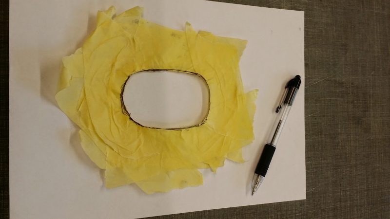

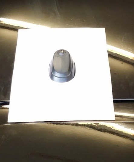

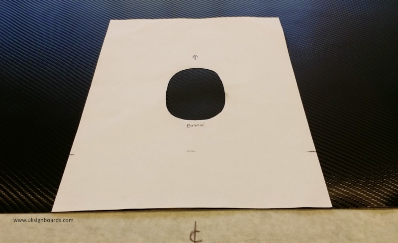

    You can create a template using masking tape.
    just tape off around the aerial and lift and lay it onto paper. cut out the shape and sit the paper over the aerial and make sure your happy with it. then cut it out of the vinyl and position.
    This is easier said than done if “working alone” and particularly up on the headboard area, trying to balance and position a large section of vinyl. It is certainly easier with the hole cut and “slightly smaller” than you need but getting everything into position on your own is never easy.
    if you have any text or logos etc in that area, i would make them separate and apply after the wrap. there is no point trying to also worry about lining up text etc. when it can be done after.
    depending on how close to the window the aerial is, you may get away with a join line from the aerial to the window. it can be as little as 75mm on some vans, granted, others are much higher though.

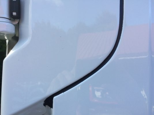

      Another issue this van has thrown up is the joins in the bodywork.
      They are filled with black goo, it looks like rubber but it is actually some kind of tar.
      Can I wrap over them?
      I really dont want to knifeless tape either side, because there is no way I will be steady enough not to get some ugly white showing through the red vinyl, and I dont want the edge of the vinyl to end up on the tar because Im pretty sure it wont stick. I tried a test patch, and the glue looks a bit stained with tar when you peel it back.
      Heres a pic.
      • Joe Killeen
        December 21, 2022 at 11:45 am

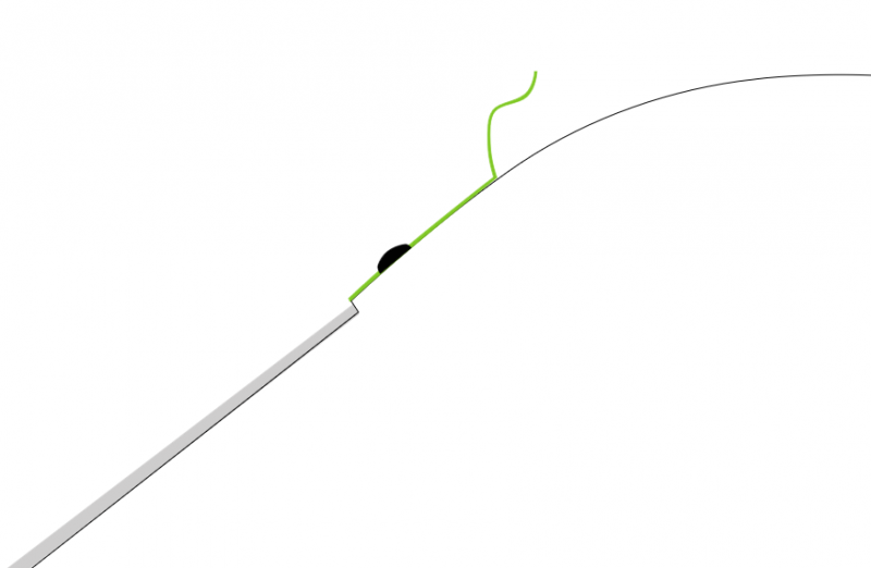

        The black is flexible joint sealer and no vinyl will stick long term, install over and with a short blade on an angle to the vehicle body cut away the vinyl over the sealer.

    I’ve done a few of these. There is nothing for it but to trim carefully with a scalpel.
    Run down right in the centre first then tuck with a squeegee and cut again as close to the paint as you can go. A little white showing is a probability. I have been know to touch up afterwards with a rubberized tyre paint and a signwriting brush. Works a treat.
    Sometimes we just have to educate our customers and educate them as to what is possible too.

    I have always made a slit on the rubber join after reading about it on this site in the past.
    I read elsewhere someone suggested putting 3M primer on it, but i have also read using the primer should be avoided on vans. personally I think trimming it or cutting it away is the safest way.
