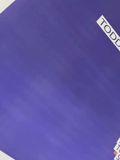

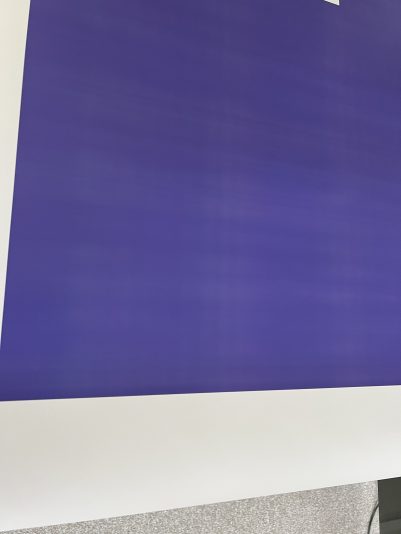

    Good day folks
    How to improve these printing lines / shades that I get on solid colours when printing pull up banner material?
    Where to look? What to change?

  • Jamie Wood
    30 August 2022 at 10:45
    I would try uni-directional, with higher passes, or high quailty mode if you have it.
  • Pane Talev
    30 August 2022 at 11:51
    That’s exactly what I did Jamie. 1440 dpi. 46min = 1 roll up. Crazy slow. But glad job is done.
    I wonder what is the problem:
    Media?
    Profile?
    File?
  • Peter Cassidy
    30 August 2022 at 12:11
    i had this when i was printing a vector colour blend.
    i changed it to a .jpg file and it printed fine.
  • Simon Worrall
    6 September 2022 at 01:28
    Most probably static. Imho.
    • Pane Talev
      13 September 2022 at 20:15
      The rest of the print is perfect. Only the green has this shade / banding. Bizarre.
    • Simon Worrall
      12 October 2022 at 00:01
      Another thing to check is the vacuum on the print bed. if its too strong, it may “hold back” the vinyl on the printer from flowing through at an even pace, resulting in some ugly uneven print lines.
      Ive certainly made that mistake in the past.
      Yes I know its only on the green for you, but its something to bear in mind.
  • Chris Wilson
    12 October 2022 at 17:58
    Could be the machine trying to hit the colour and it’s not. Change to a spot colour that’s the closest shade of purple you can find and it should come out a lot better if not perfect
  • Pane Talev
    26 October 2022 at 19:18
    This turned out to be the material.
    When no solid colour background is printed, print quality is spot on.
    When background is printed, because of statics, the banding / lines appear.
    Looking for new roll up media.
