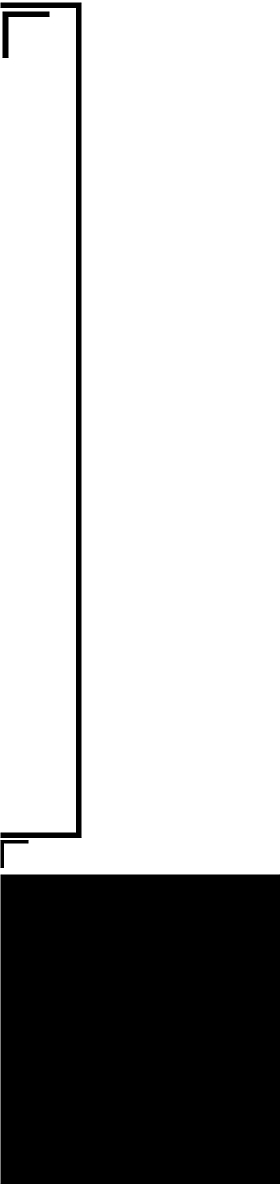

    Rivet the fixing angle to the bottom return so the angle is facing out this allows you to screw the tray on with out the shutter bos interfering and due to it being so close to the sutter you will not see the angle.
