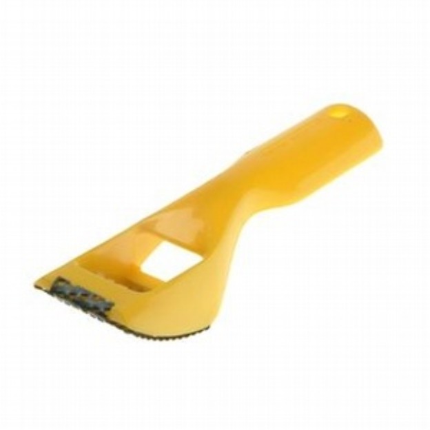

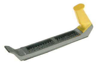

    What’s a sureform Gavin?
  • John Harding
    July 28, 2011 at 10:20 am
    Think Gavin means surform, get in hardware stores B & Q etc yellow handle with rough bit on the bottom 😀
  • Harry Cleary
    July 28, 2011 at 10:30 am
    One of these boyos…many the knuckle I sheared with one at college…ouch! 🙁
  • Gavin MacMillan
    July 28, 2011 at 10:41 am
    That’s the bad boy, though there is a much shorter one that some prefer.
    G
  • John Harding
    July 28, 2011 at 11:23 am
    No Harry – Little ones better 😀
