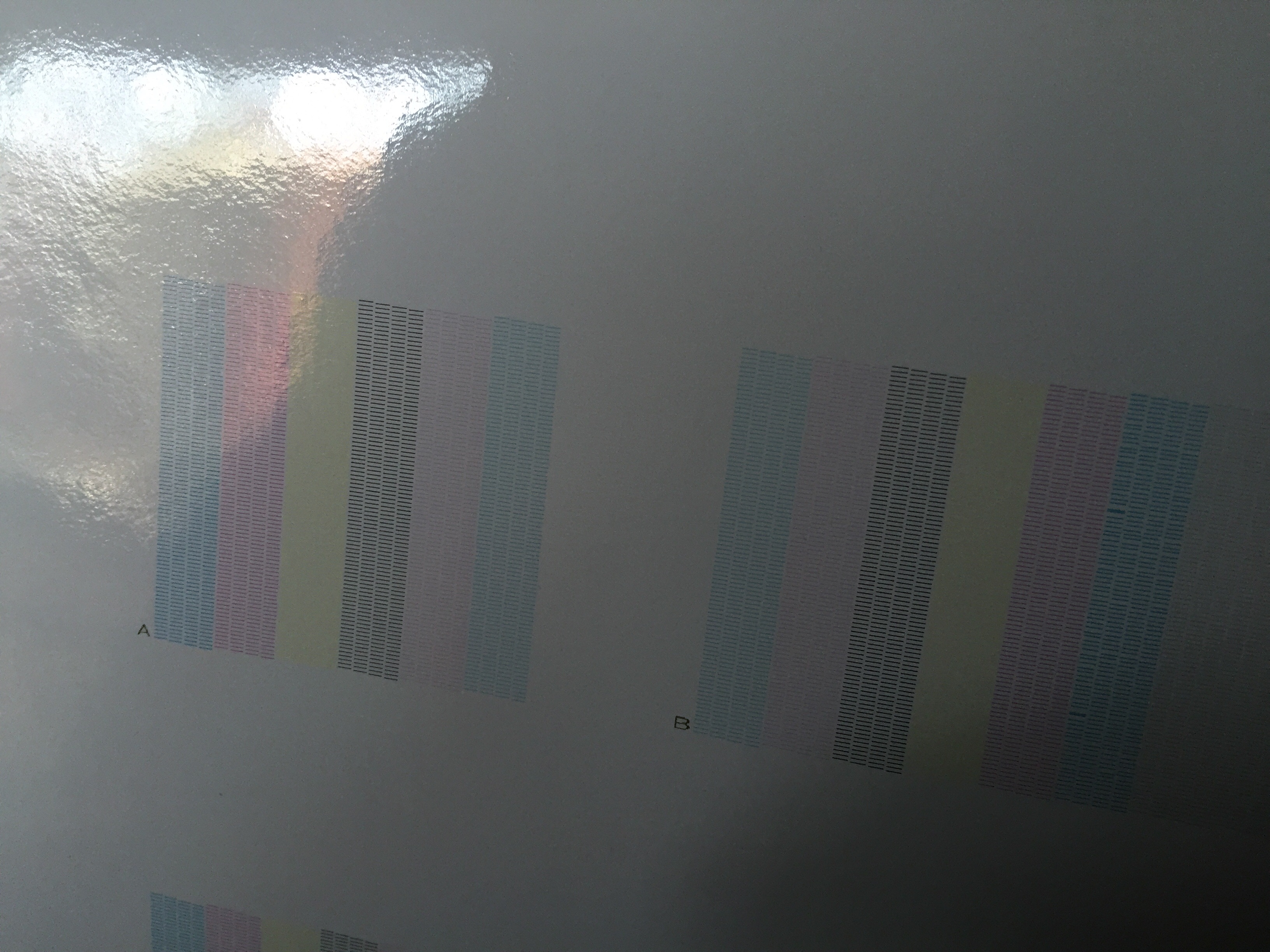

    Although my issue isn’t as bad as yours you can see the image below. I’ve got se head deflection on my cyan and it’s giving me white lines in anything that has cyan in it.
    I did a couple of powerful cleans and manually cleaning bottom of head and it got better but not perfect.

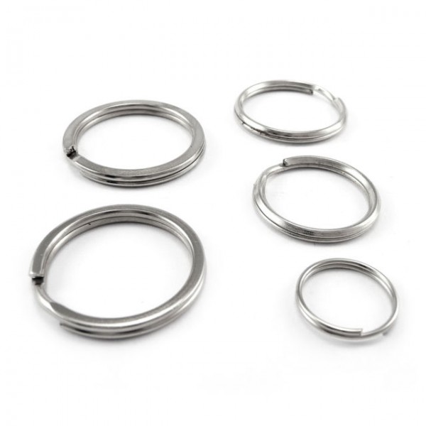

    we have/had the proper little plastic crimps. cheap and can be bought from your supplier. they just press in and clip instant. however, i have used some tight fitting keyring loops to pinch it. have loads lying around and works well if stuck. 😀

    Well after some head soaking for a couple of hours and some powerful cleans my cyan deflection looked a little better but not perfect.
    Ran a couple of test prints and on the third or worth test print the deflection was almost back to the worst it has been.
    As it was a Sunday yesterday I thought I would give it a go and see if I can get this working….No time left I’m looks like I might just have t have the head swapped out. Got some high end bits of work that need to be printed and just can not afford to take the risk of it not looking right, especially the price the media its being printed on.
