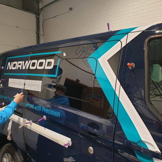

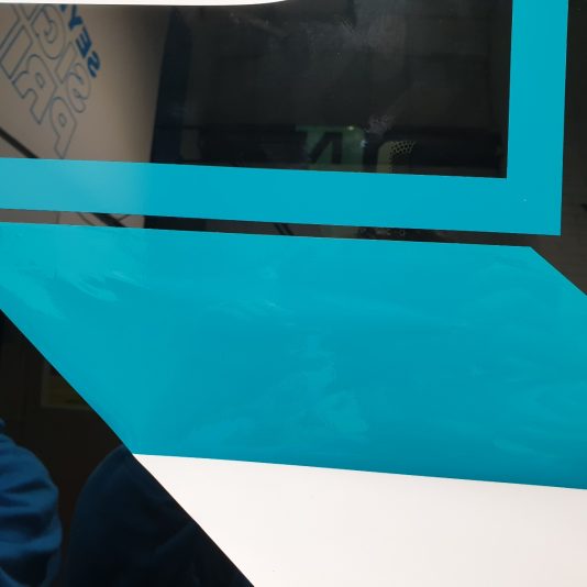

    Here’s a couple of photos.
    The blue and white stripe was printed on Arlon SLX, the cut text and border on the logo M7 cut vinyl.
    Biggest difference is the level of gloss on the SLX compared to the M7.
    24 November 2022 at 19:24
    That’s not a bad match, David. 👍
      24 November 2022 at 20:03
      Quite impressed myself, its a bit of a funny colour to match too.

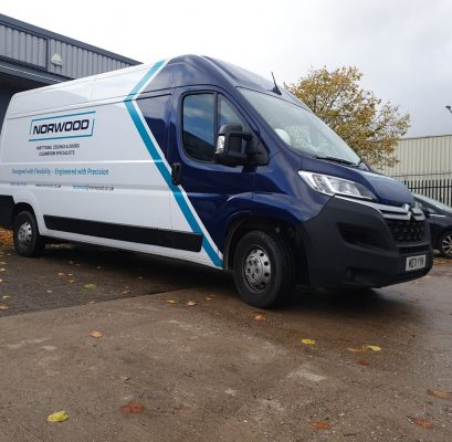

      Pic of the van outside for more context.

      25 November 2022 at 12:27
      Same one perhaps, they seem to be a fair sized company.
      To be honest it was actually not too bad, the SLX helped. Printed and cut the angle in one, and the long line, seperately, along with the rear doors.

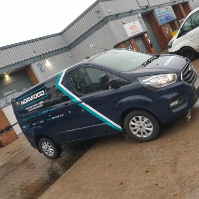

      Easier than these ones, wrapping the front end in Dark Blue, luckily opted for Avery Supreme to make lighter work of the install, especially over the cab!
    25 November 2022 at 13:57
    Nice one David, you can see the design elements working together much better on this one due to the blue front. 👍
    Avery supreme is definitely a much more forgiving wrap to work with.
