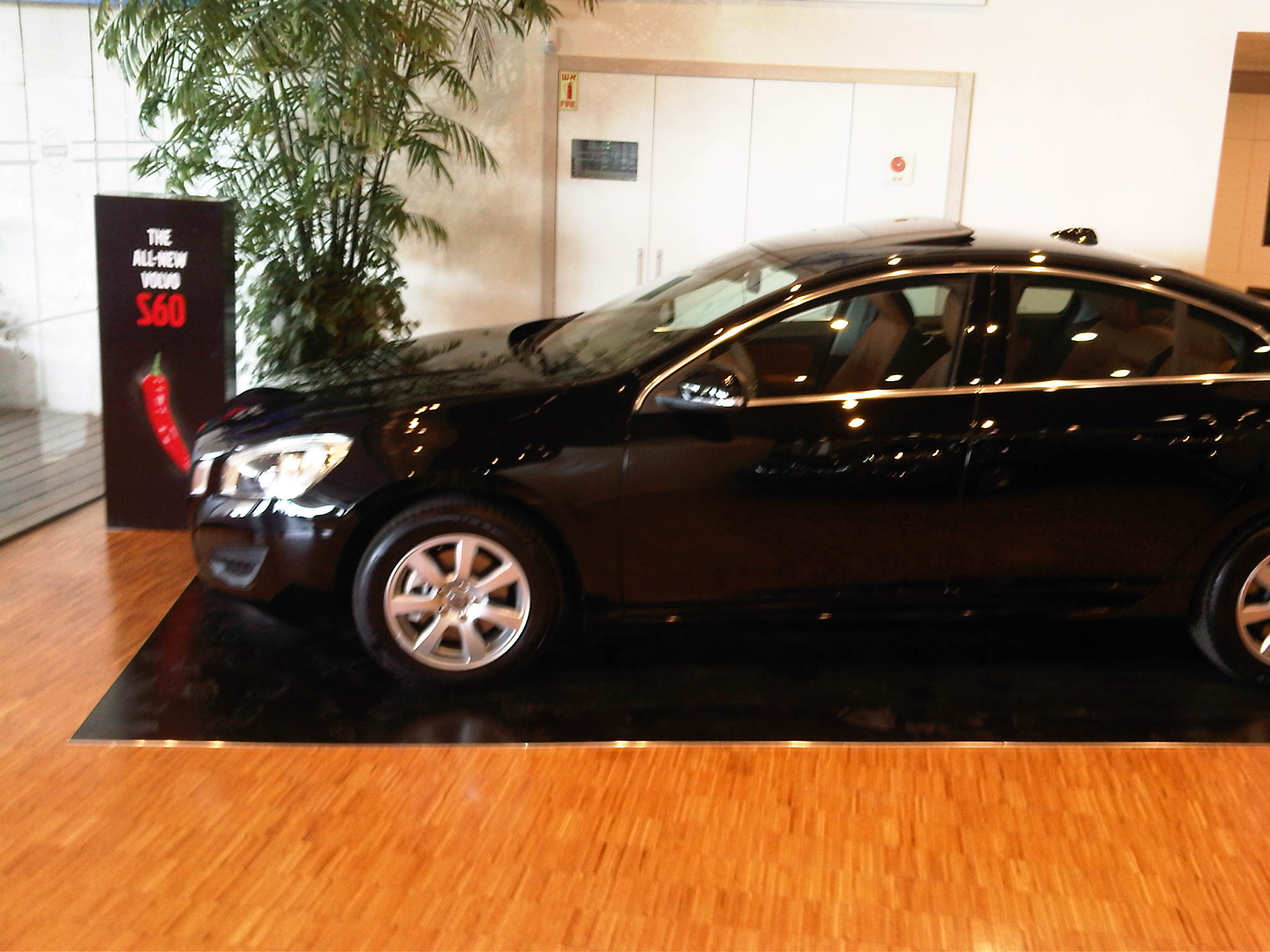

    Here is an example of an old work of applying DBond to floor and then putting a car on it in Israel. Just gluying it to the floor, joining the panels with 3mm aluminium profile.
  • David-Foster-
    10 July 2011 at 07:18
    quote AdamZeit:
    Hasn’t that ruined the floor? I would have just taped it to floor, gravity and all that 😀
  • Adam Zeit
    10 July 2011 at 07:26
    Used double sided Tesa-Tape for the panels and aluminium profiles indeed.
    It shoule be a one month project, however it is on for almost a year already.
    Removing the panels shoule be very easy, and re-installing too. the only thing that should be replaced are the profiles.
