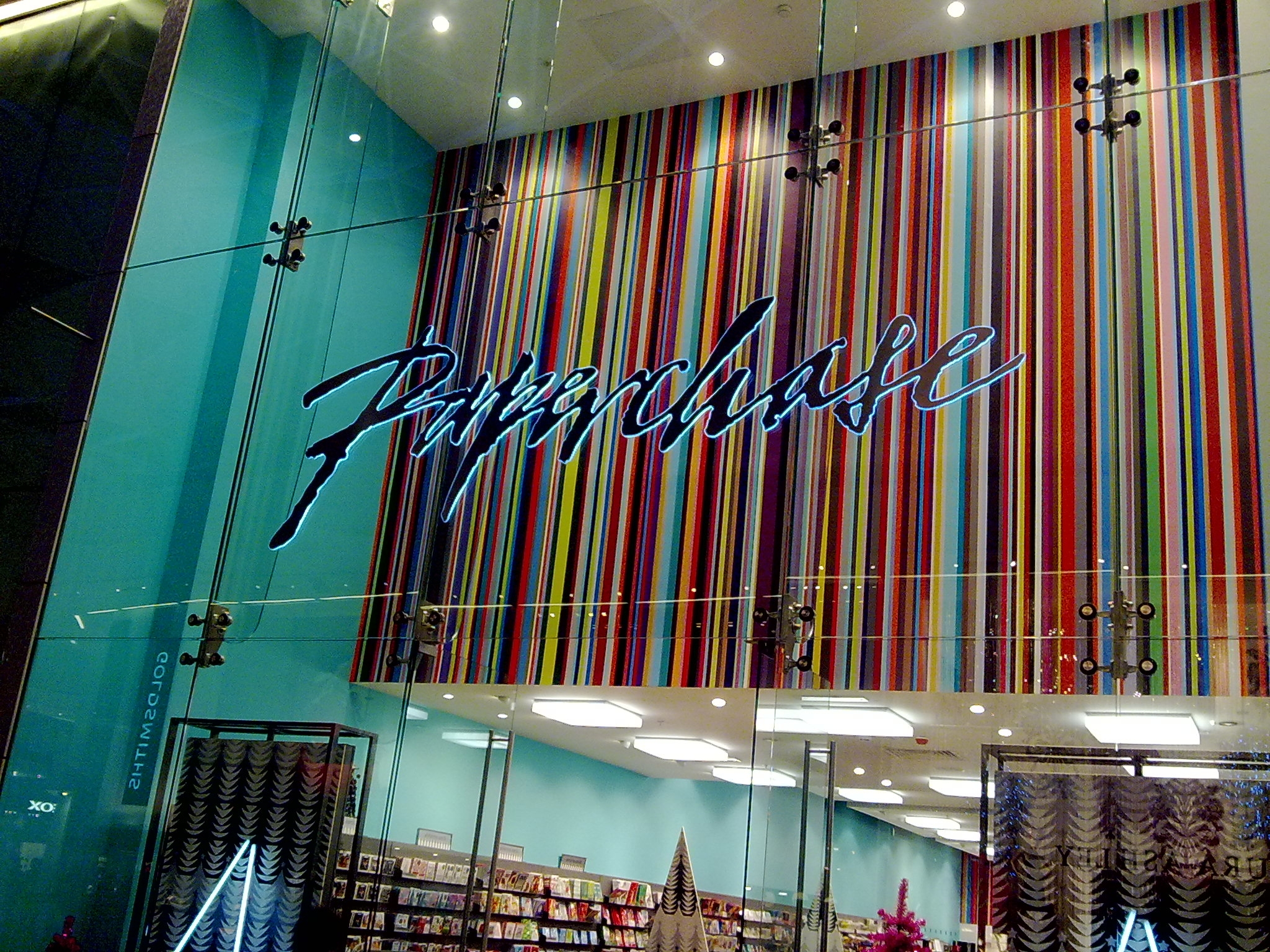

    Took this picky at the new Westfeild shopping center at xmas its an illuminated sign 10 mm acrylic faced with brushed stainless it is fixed to the center of a large plate glass window from the back and spans over 3 pieces. What i cant get to grips with ists probably LE D’s but there are no visible wires I looked at this for 15 minutes trying to work out how it was possible can anyone put me out of my misery.

    ok quick guess…
    this is a very rough explanation and i cant for the life of me remember who was selling it but we had a few quotes from them, maybe it will jog someones memory.
    there is an acrylic, the stuff i was looking at was about 10-15mm thick.
    it had embedded LED’s within the acrylic and all it required to illuminate bright, was a a single wire/power source.
    you could have the acrylic cut into any shape, logo, size etc and illuminate the whole thing by adding a simply power source. downside was you couldnt buy the acrylic you had to send the vector file and the company router cut it for you and supplied.
    so in short… if no visible led’s etc then its probably done using this product.
    to run the power source and hide it they could probably run one of these thin black wires down between the JOIN of the glass panels into one letter which will illuminate the whole sheet of acrylic as the letters are all joined in the script font?

    We were involved in a near replica of that sign, but through our electrical business, not the sign business unfortunately.
    Magnetic "gas" if you like, is correct 😀
    Just having another thought on it, is it possible that 2 sheets of accrylic can cause an optical illusion to hide a wire???

    I would of thought they would of gone for Robs method.
    What would be the point of them going to the cost of having "magnetic" gas so that a one of us can look at it for 15mins and wonder how they do it.
    And looking at that photo it does half look like there are wires contained within that gap.

    i did a quick google on this one and although its definitely NOT the acrylic sheet i was getting quotes for, it does a very similar job.
    Click Here

    What they use to stick the logo to the window?

    they could have used a UV glass adhesive where they apply the adhesive to the rear of the letters and move into position and fix using a temp fixing such as glass suction grips/clamps.
    once being held in place you run a hand held UV Lamp over the rear of the letters and it will cure in about 10-30 seconds, SOLID!
    this same method is used to fix clear glass shelf’s directly to windows and mirrors only held by the edge of the shelf in contact with the glass. its a very strong bond as you can imagine.
    It is also used to apply crystal diamond bevels to glass panels for decorative lead work for homes and offices. same curing procedure.
    at least i would assume this is how it would be fixed without any visible fixings or adhesive.
