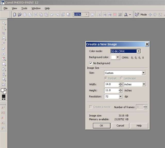

  • steve geary
    17 February 2006 at 14:33
    Dave,
    I belive what you’re missing is the page with no background.
    Open a new blank page in corel photpaint.
    check box with NO BACKGROUND.
    Make sure the page size and dpi will match your image, or at least the dpi.
    Drag image to that page
    remove backround with eraser or masks or whatever
    save that as cpt
    drag or open into coreldraw and there will be no backround.
    i think somewhere you can set it to be default no backround when you open any file in photo paint…. but i haven’t found it in twelve yet.
  • steve geary
    17 February 2006 at 14:44
    don’t forget to crop the whole page down then, after you’ve removed the background, the image will still be the size of the page, only transparent.
