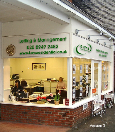

    I did a complete cover-up of crappy shopfront with 10mm foam, then rollered it with weathershield satin (customers insistence).
    Looks fine but gloss may have been a bit different.

    Useful information. Its seems like the paint’s holding well. Thanks for the visual.
