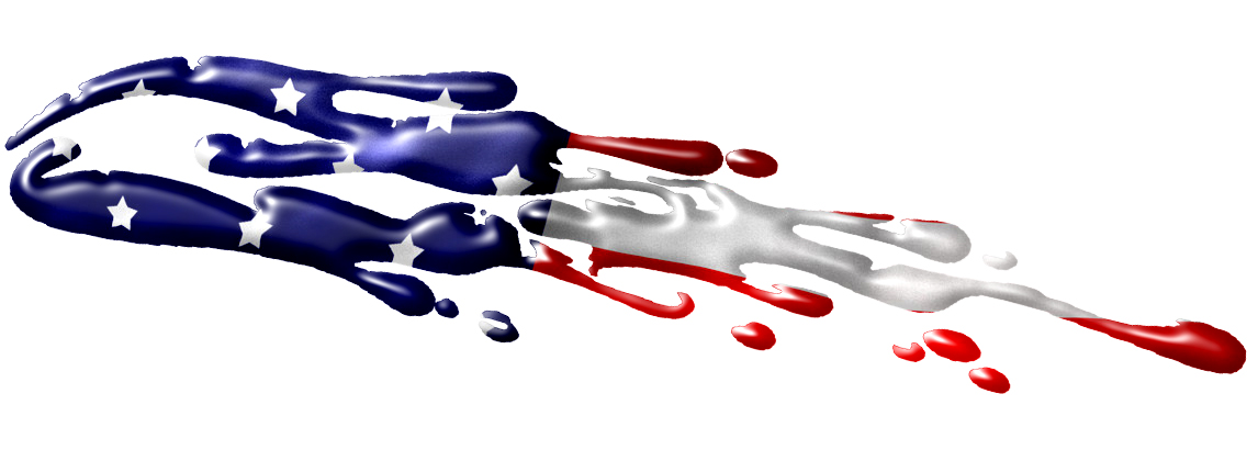

    Did this in under 3 minutes – including sourcing a new flag.
    All low res – just for a quickie…it’s just a rough.
    Photoshop.
    Import both images.
    Use magic wand to select background of splash (adjust tolerance to suit).
    Invert selection
    Copy
    Move to ‘new flag’.
    Paste
    Delete (DEL)
    You should be left with ‘dancing ants’
    Change layer to ‘new flag’
    Invert selection
    Delete (DEL)
    Filters – apply bevel and adjust contrast.
    Add shadow if desired.
    With better images & by pumping up the resolution – it could be made super smooth.
    A vector mask could also be used for a superior clipping mask by importing an EPS you’ve traced or drawn.
