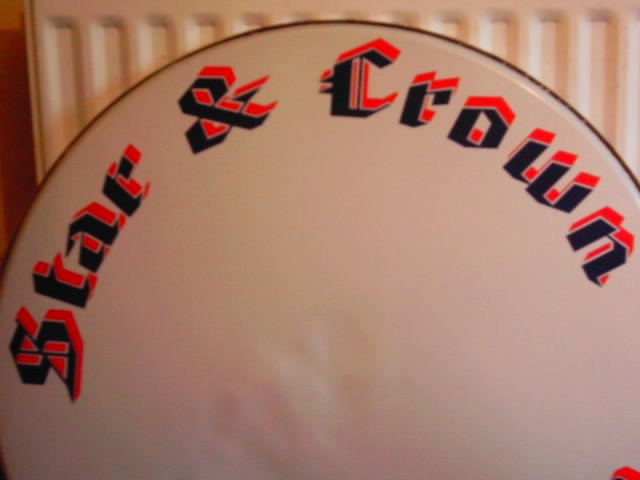

    ok I know this will be simple to sort and feel silly asking but its doin my head in!!! putting text on inside of a circle but its too tall and narrow, so before putting it in I shorten it and broaden the text, then put in circle but it goes all shapes! what am I doing wrong?

    follow curve l, I can do this no problem when I have not altered text but I have to alter it to make it shorter and broader. any help and theres a pint in it!! :lol1:

    like so!! When I adjust the height and add lenght to broaden it , add to curve its not right! 🙄
  • Bill Dewison
    13 March 2005 at 17:52
    Really easy one. Rather than trying to fit the text inside the circle, make a new circle that is much smaller, to the inside edge of the text. Then Fit To Path within the text options, and you’ll find it easier to manipulate.
    One minor problem with CorelDRAW is it will do strange things to files when you’ve done a Fit to Path within them. I would convert the result to curves once you have what you want.
    To make the effect you’ve shown is relatively simple, the original text is fitted to the curve (or circle in this case) then duplicated. The duplicate is offset to the original, then the original is given a small outline. The outline is seperated , then trimmed from the duplicate. Hope that makes sense 😕

    14 March 2005 at 08:34
    Thanks Lanie, got is sorted 😀 just had to place each letter one at a time 🙄
