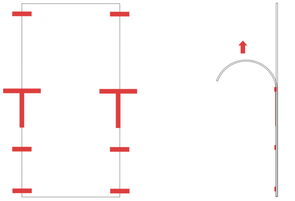

    Here is a method I have used for many years installing truck wraps “outside in the sun” with non-air release cast vinyl.
    It keeps the vinyl square and perfectly aligned but also limits any stretch you may get over the length.
    Basically masking tape the panel into place as shown.
    flap back the top half and peel out the lining paper and cut off excess paper straight and fold 50mm back on itself.
    Apply the vinyl from the middle to the top.
    then remove the masking tape and apply the bottom half.
    You will see I have formed a “T” in the middle, it is important to make the T, 2-3 layers of masking tape or it will simply tear with the weight of the vinyl being folded back on it and the whole thing will come away.
    The “T” should be about 600mm deep by 200mm wide at the top, minimum…
    The picture on the right is a side-on visual.
