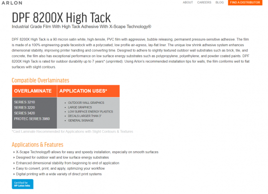

    The thing with flexi-face signs is that they are UV printed onto a banner-type material.
    UV INK has a micro-texture to it and the banner material is not gloss or completely smooth, and also moves continually in the wind.
    To allow for the micro-texture and movement I would definitely want something with a more aggressive tack and minimal shrinkage as possible.
    Do not get me wrong, I think the life expectancy of the sticker/job is what will ultimately decide on what you will go for. The following is just a suggestion, there are similar products under different brand names.
    I would suggest something like Arlon DPF 7200X High Tack.
    Full details and spec can be found here: http://www.Arlon.com
    Suppliers:
    https://www.williamsmith.co.uk
    https://www.spandex.com
  • Graham Scanlan
    October 4, 2022 at 5:48 am
    Hi guys
    Rob was correct recommending High Tack, but you need to consider the movement in the flex face, the Arlon product if for flat surfaces. You could consider
    https://www.mactacgraphics.eu/en/product/jt-5826-p
    Mactac JT5826 is a High Tack Vinyl for flexible pvc surfaces
