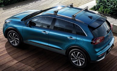

    is this the car?
    of the two I would go with 3M. Hexis will do it no sweat but user friendly I would side with 3M.
    are you allowing for the fin on the roof, do you have a game plan to tackle it?

      Hi Rob, Yes that’s the one. I’m actually looking at the 3M 2080 now which I believe is the next gen with protective film layer.
      I hadn’t actually seen the fin. I guess that will be a bit of a pain!! I have a feeling I’ve read something about them somewhere before & that removal is tricky! I don’t see it being a problem to trim around for the roof but to wrap it I’d imagine could be tricky!? Any tips?
