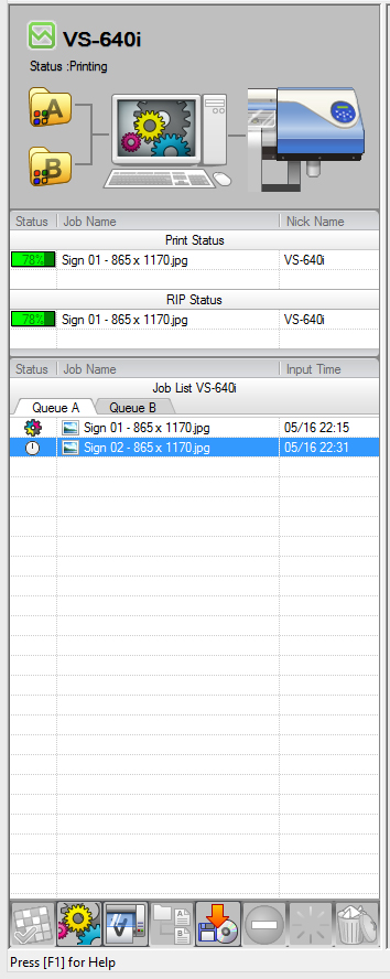

    Posted by John Mackenzie on May 16, 2014 at 9:40 pm
    …why do I have to wait for the second job?
    I am ready to go home but I cannot double click the second job to set the print details, what makes it sit with a ‘timer’?

    I would imagine this is down to RIP engines.
    All ripping softwares have RIP engines…the more you have the more jobs you can process at once.
    I’m not sure if there is a work around?
    I know Roland staff use these boards perhaps someone can comment here?

    Hi John, my workround would be to look at ‘nesting’ the jobs to get them treated as one print run. You can select the jobs within the ‘nest’ to set parameters.

    I think it’s a glitch in the program, when it happens try dropping the same file in to the queue again, quite often it will go in fine.

    I didn’t think of trying that!

    I couldn’t nest it as I was still setting up one job while the other was printing.

    Bit late I know but that usually happens when one file is ripping the ink usage estimate can’t happen until the previous rip has finished.
    Steve
