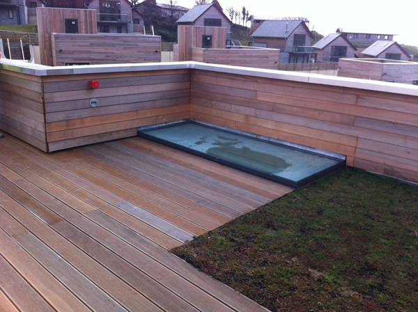

I need some advice on a job I need to quote on, Its for some roof skylights as pictured.
I need to cover them with something that will let light through.
The are made of 45mm frosted glass, and when dry are fine, as they are opaque enough but as you can see when wet they show the frame for the light fitting through them. the builders are concerned it looks a bit tatty and unprofessional and seeing as the windows cost 4.5k a piece they want it to look a little more "finished" frosted etch would be fine but would also be slippy if walked on, and would also probably need replacing from time to time due to the sun being on them all summer etc, this could all have been avoided had they contacted me before fitting as i could have applied it to the underside.
They are all now fixed and in situ so the only option is to apply something to the top, and whereas window etch will suffice and be opaque enough we have the risk of people walking on them and slipping, I can put warning signs up but was wondering if anyone knows of any material like etch etc that has a non slip surface, I have advised them I can fit vinyl etch to them but cannot guarantee how long it will last as if someones up there in golf shoes or kids picking at it etc I cant say how long it will last even though its 7 year vinyl. so, is there any material that is non slip opaque and suitable for what I need, as I have asked about and cant seem to find anything more suitable. I also considered contravision etc but cant find anything more suitable.
any ideas welcome.
