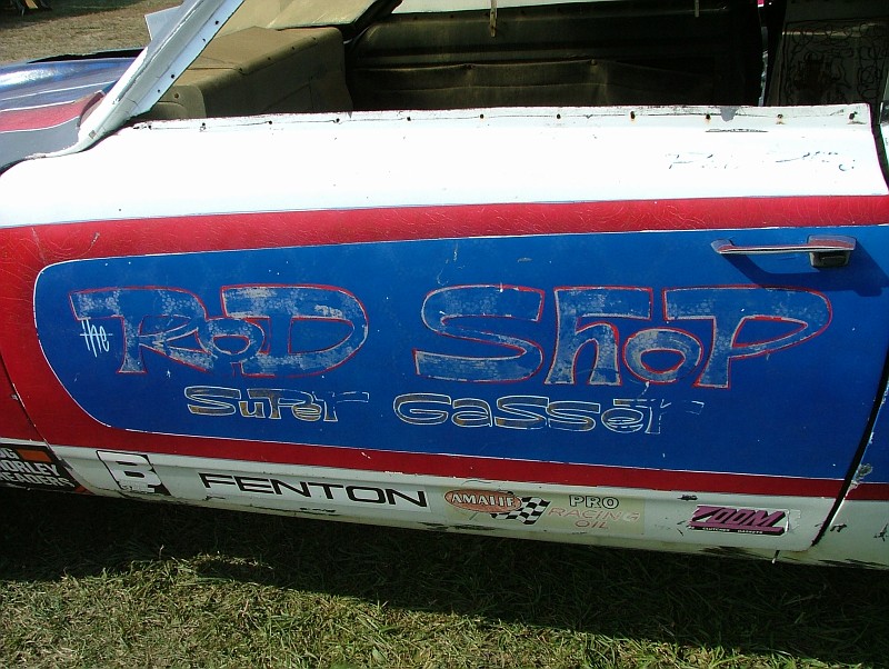

    I have a new project to do… Mate of mine has a 1963 Plymouth that is in its original faded and rubbed through paint. Real patina! Looks fantastic. He wants me to do some lettering on it. But the lettering needs to look like it was painted 40 years ago. So it needs to be worn and faded. As well as rubbed through in places. Any Ideas on paint and method on this one?

    Bit like this… I was thinking of using HOK. Not going for full coverage. then age it with a few scratches, and some t-cut.
    The reason for HOK? Or other solvent, If I used Water based paints, I would have to clear it with something…..
    Would still welcome some input though! PLEASE!

    Have done similar on walls and boardsetc. never on a car body though. I would rub on some candle wax first, paint and then rub back, and then make up a succession of staining washes to rub over the remaining paint, depending on how old I wanted it to look.

    Thanks Jill…. It is VERY popular at the moment. I have seen someone attempt it with one shot, then rub some off…. But it looked like new paint that had been scrubbed off a bit!

    Steve Vandemon specialises in faux sign work on very old gas station signage and his advice was this, if you build the edges with xtra paint to get a ridge and then sand back, you can get more natural chips and relaistic looking fades.
    Hope that helps. If you pay us a visit in the New Year we can go over it in detail. I reckon hand lettered in One Shot or any other sign paint or even, if you go for the Auto-Borne route which we all now LOVE 😉 you could paint it much much easier, you already have the materials AND once you have arrived at the finished faux look correctly you can take an exterior clear varnish and simply re-letter it over the signs overlapping slightly by a few mil at the edges to lock it down.
    A good varnish or even try the Top Coat by Medea as this will build nicely and you could cut paper or card templates to mask the lettering and simply spray the Top Coat over as it is Solvent-resistant when dry and moves a little due it’s acrylic properties.

    Perhaps sponging or crinkled plastic wrap might give the effect you are after. I would try using a slow reducer with the HOK and then dab at it with a sponge, wrap or bunched up paper towel.
