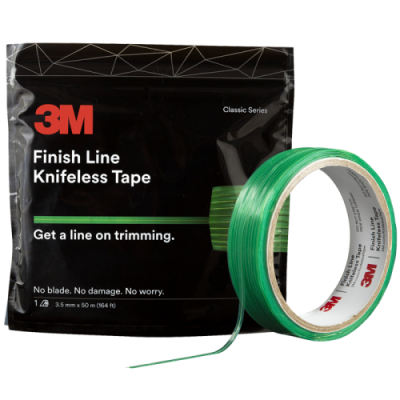

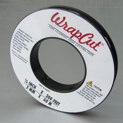

Also make sure you are using Design Line for curves as Finish line is a bit harder to curve, WrapCut is another type of knifeless which is a lot more difficult to use than 3M.
You are correct Joe with regard to design line, but I am not keen on it and prefer finish line as more of an all-rounder filament tape.
RED wrap cut, I also like as a general all-rounder and much more cost-effective but bends in one direction, it is also harder to get these days as I think it’s the white one they do now, which I am not keen on.
