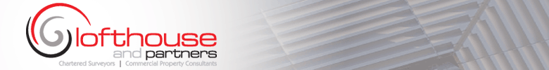

    Ive been asked by a good customer to do something "elegant" with his existing logo for display on the chimney breast of his office. He has said he pictures it as "Sticking Out".
    I could go the easy route of just getting the letters flat cut and mount on locators but I am not sure the swirl in the logo will be a cuttable piece.
    Id like to do something eye catching and special for him as their is the potential for alot of work from him.
    Does anyone have any ideas that can stir up my creative juices?
    Its just the logo to the left of the image he wants.

    A lot will depend on the size as it may work out some parts will be very small and locator’s on the backs will just look bad

    Thats my worry Richard. I was thinking about trying to come up with something where I could just use VHB tape and flat cut letters to still give a sort of embossed look.
    Im going down when I get a chance to see the area, but id imagine it to be a standard sized Chimney Breast in a converted Victorian House.
    Im expecting the area to be about 72" wide max.

    As Rich says it would depend on the size but you could glue 3mm clear acrylic rods to the backs if they are pretty small

    I quite fancy using a brushed stainless fascia but worry the grey letters will look lost.

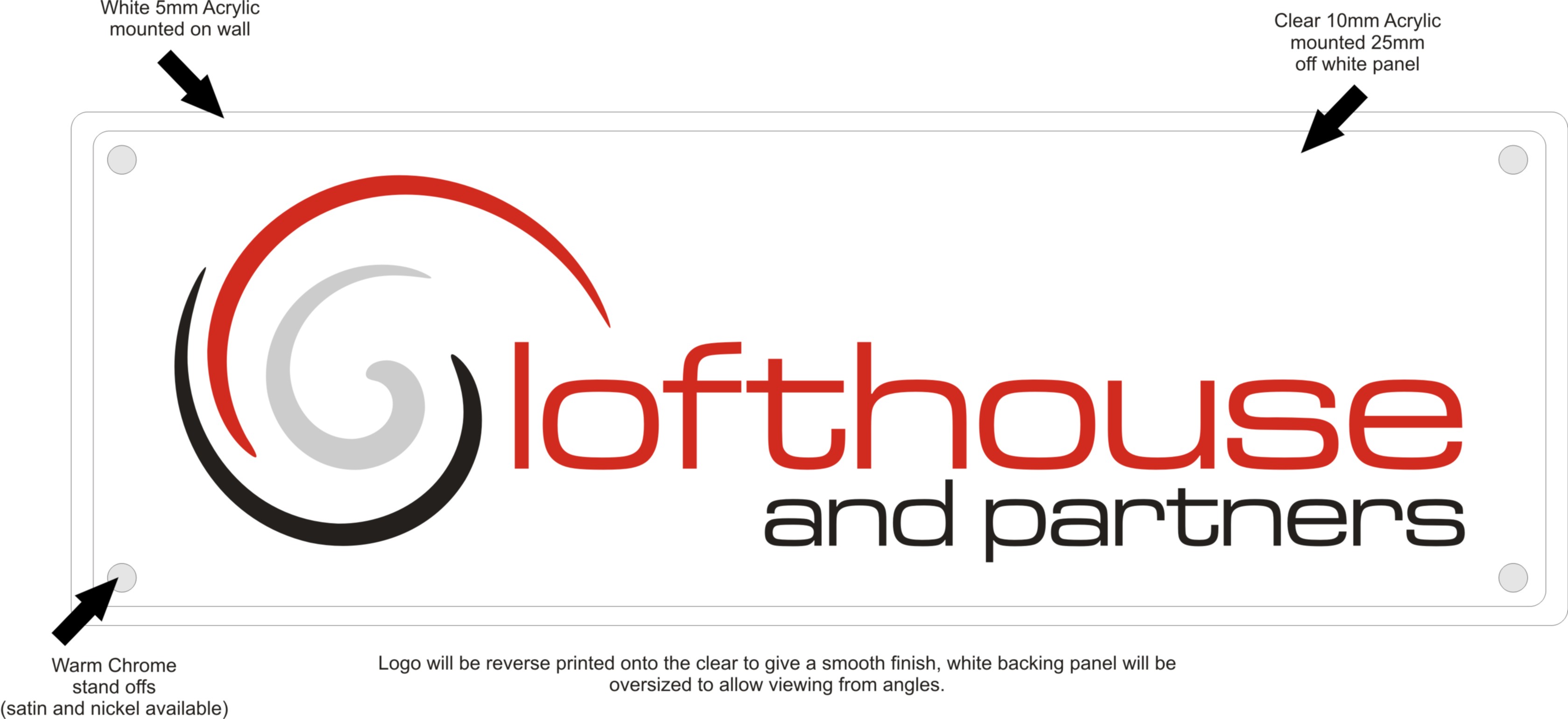

    Im after opinions on the two ideas for the office plaque. I like the coloured one standing off the white (cheers for the help Dave) but the customer is keen on etch against clear. The wall is red and I think etch on clear will be lost against red. Ive also toyed with an all silver logo but still prefer the clear on white.

    Paul can you post a jpeg please

    Im not good converting CDR to JPEG, the colours never look right.
    Ive had a go though.
