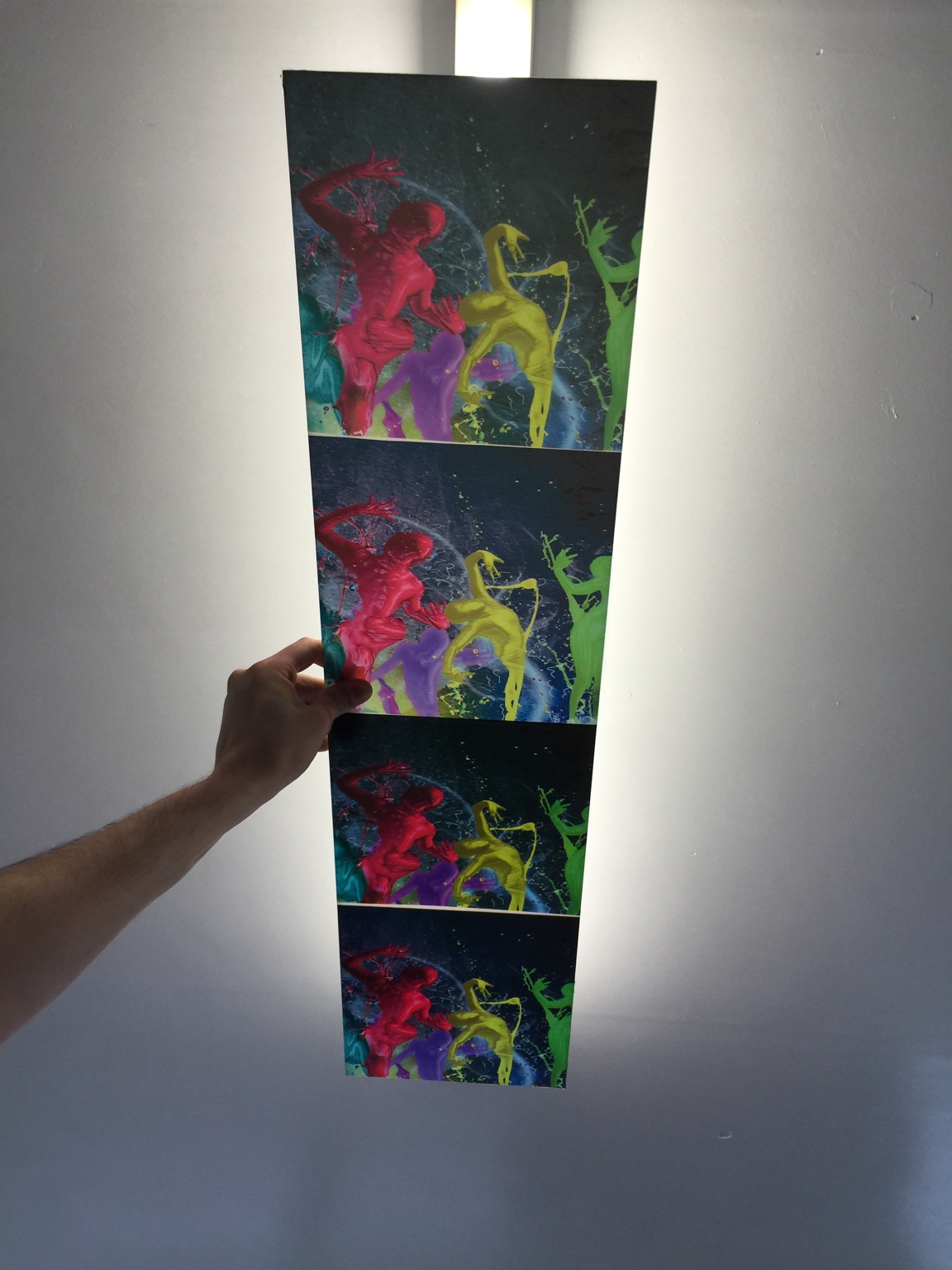

    July 28, 2016 at 6:19 pm
    Ok so ive ran a few print tests on 5mm opal with clear vinyl printed. Thought i would upload my findings…
    Top to bottom print order
    Rf640 uv ink
    sp540i solvent
    Rf640 uv ink overprint
    sp540i solvent overprint.
    I think the sp540i seems to be giving me the best results but im sure i could increase the contrast on the uv ink!
    Thanks for the tips!
