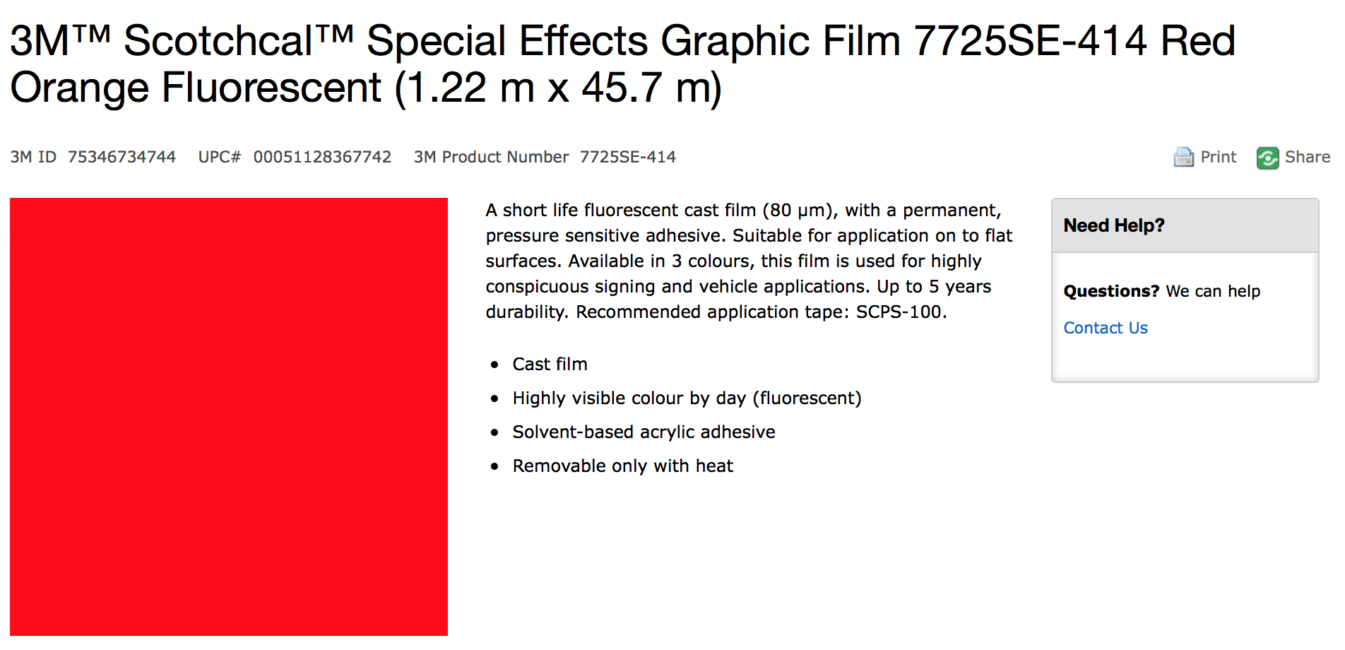

    January 22, 2017 at 2:24 pm
    This material looks about right!
    Do you think if this was applied onto an IJ180 film it would have better longevity? Would definitely make it an easier film to work with I’m sure!
    January 22, 2017 at 3:07 pm
    No I meant i call it "Day Glow" too, to describe Fluorescent. but many don’t and just term it that because it’s bright.
    If you have been told its 3M then that is probably the one. 5 year cast.
    laminating it onto another will increase your costs, it will not increase the life of the film.
    if your laminating it to a control-tac media then yes it will make installation easier due to the adhesive system and also because it will thicken up the cast and make easier handling. should it fail on you your on your own right away though.
