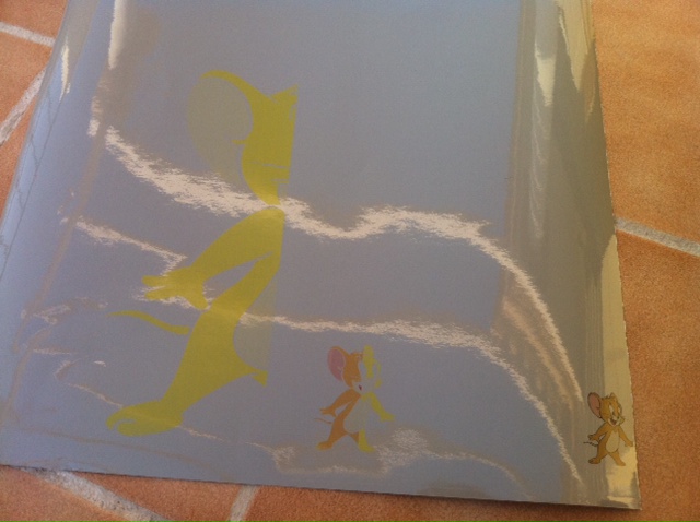

    HI please look at my attachment i have a roland pc600 and when i print it stop half way trough im using flexi 8.1 on printing somthing small as you see is ok but as more data there is the less it prints, i am new to all this and need a little help, oh by the way when it cuts its fine, but not sure that is becuse theres less data?????????
    thanks
    kel

    My guess would be the file is poor i don’t think its the printer.
    You could convert it to a bit map then print it or try the proper rip for the printer.

    As Chris says’s, it looks like the file is suspect. Try printing a few squares or shapes in various sizes as a test with spot colours. If they print fine then all should be OK on other prints as well.
    Also not sure on what vinyl that is in your picture but if it’s chrome or metalised type be wary that it will also give inconsistent results based on what colour your’re printing with.
    Try good quality white vinyl for testing.
    Al.

    Yeah tried 3 different images and all the same? Just stops half way through unless its really small???

    those type of clip art pics are prone to disaster and the magenta has stopped at the same place as the yellow in the larger one.
    convert it to a bitmap and try again or view it in wire frame and you will probably see a line from the ear going down.
    as alex says print 4 500x10mm strips across the printer to test CMYK
    if they are fine then the printer is doing what its told.
    unless you know better use the driver rip that was designed for the printer can save a lot of hassle

    Just tried printing a jpeg photo and same result I’ve tried using different vinyls and same result could it be my cable?
