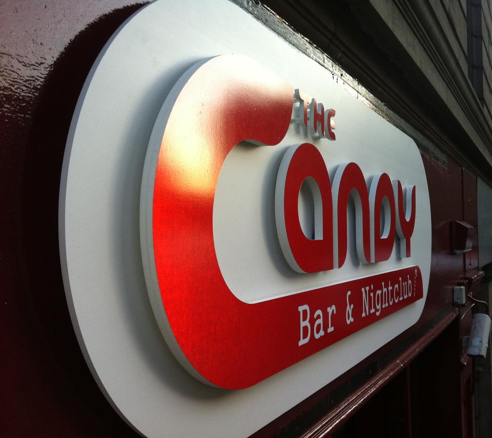

    sorry to say it but budget job ie. LEDs stuck to the back of flat cut look budget with uneven lighting at best.
    I personally wouldn’t recommend it.
    There are several fine examples in Dundee done by an otherwise reputable company that for whatever reason thought white LED modules behind white flatcut with white vinyl behind it would work. They are honestly some of the worst looking signs in the while city…basically illegible…and I have to pass it every day.
    I’ve made 20 to 40mm deep 3D letters with internal LEDS at a fraction of the cost & time of traditional acrylic….will upload it sometime. Results are pretty damn good! Looks better in the flesh – phone cameras are just rubbish at low-light. Hollow interior – there’s a 8mm rim of machined material round the edge exactly the same size as the face…strip LEDs go inside for an even illumination.
