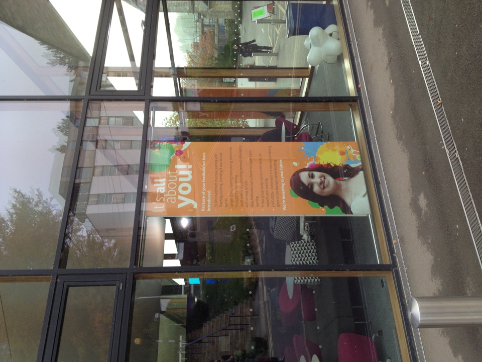

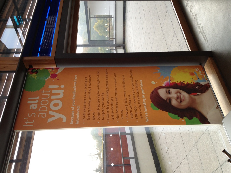

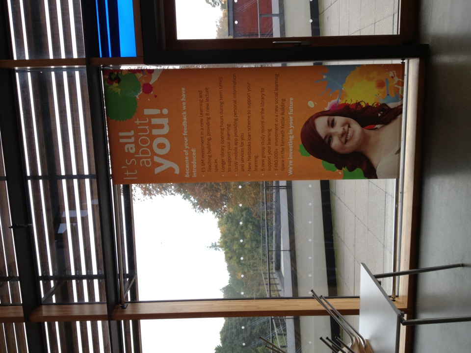

  • Warren Beard
    October 27, 2012 at 5:05 pm
    Job done, thanks to Kev for the link for the adjustable ends and found a supplier for suitable poles. Worked very well and looks good and customer extremely happy.
    Once tightened I couldn’t move with my arm strength, I didn’t hang on it as I’m a big lad and I’ll drop anything :lol1:
    Added a piece of 5mm PVC foamboard with VHB tape as a double safety feature for peace of mind.
    Thanks for the help guys
