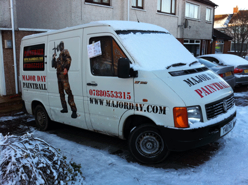

    I did a van today onsite for customer and it was -5 after 2 hours i thought i was having an outerbody experience it was that could i was in pain.
    I was using Avery 700 & 900 and it seemed to take okay, (half expecting some comeback though but it was an urgent job, also had the heat gun with me but had no electric nearby)

    I done a Midi van years ago, wet application, and it froze that night. It would have been finished for around 4hrs when it frosted over.
    It was a lease van, and it lasted for the duration of the lease. That was in 3m, but I’ve had similar with ultramark.
    The icing over obviously can’t be a good thing, but stick a random vinyl letter somewhere discrete on your vans tomorrow, when it’s freezing cold, don’t warn the panel, just ensure it’s bone dry. Then this time next year post what happened to it. It’ll still be there!

    yeah thats all i did today made sure it was bone dry, no ice and warmed the panel as much as i could with my hands before i applied….. Your a brave man doing a wet application in the cold.
    Cant remember the last time i wet applied anything, probs some floadcoated windows at the beginning of last year.
