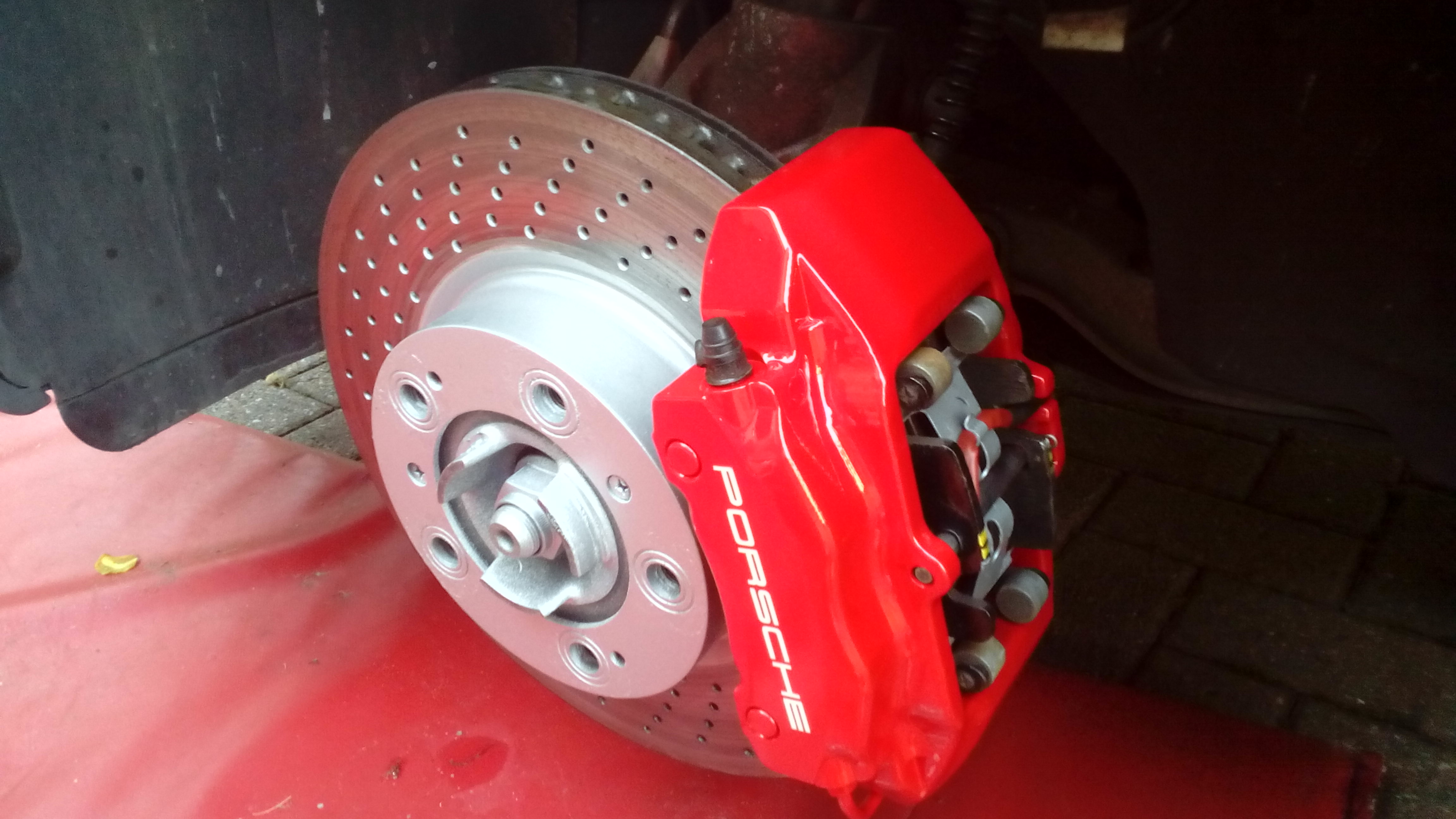

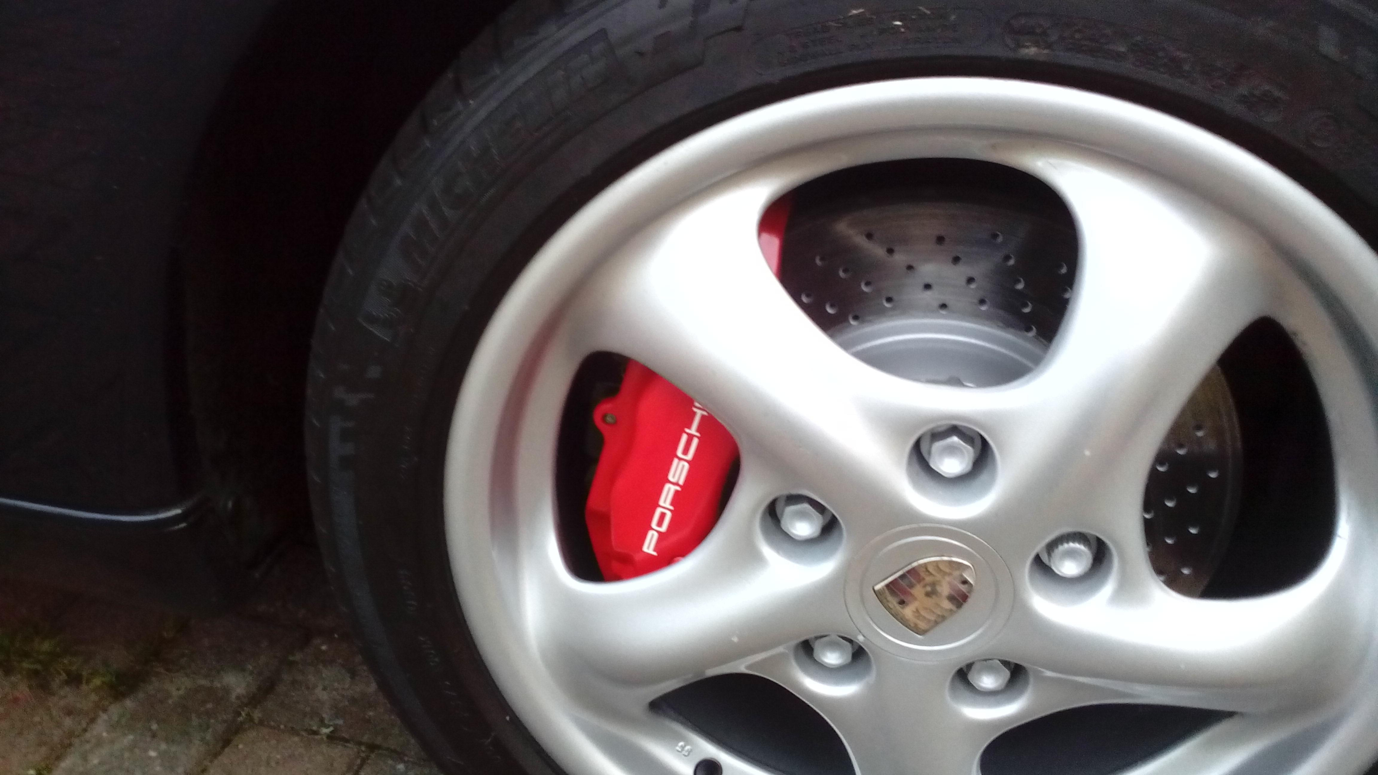

    I refurbed my calipers a few years ago…….painted with VHT paint, applied normal vinyl lettering then applied clear VHT lacquer.
    Never had a problem with them.

    Thanks for that John & as it’s only for family that would be worth a shot. Out of interest what sort of car do you have & do you ever do track days etc? These would be going in a Honda Integra Type R & possibly used for track days. And as Andrew noted above, temps can get considerably higher with this sort of use as opposed to general road use.

    Ha Ha! Well that should certainly test them well enough I’d say! :smiles: They look well too :thumbsup:
