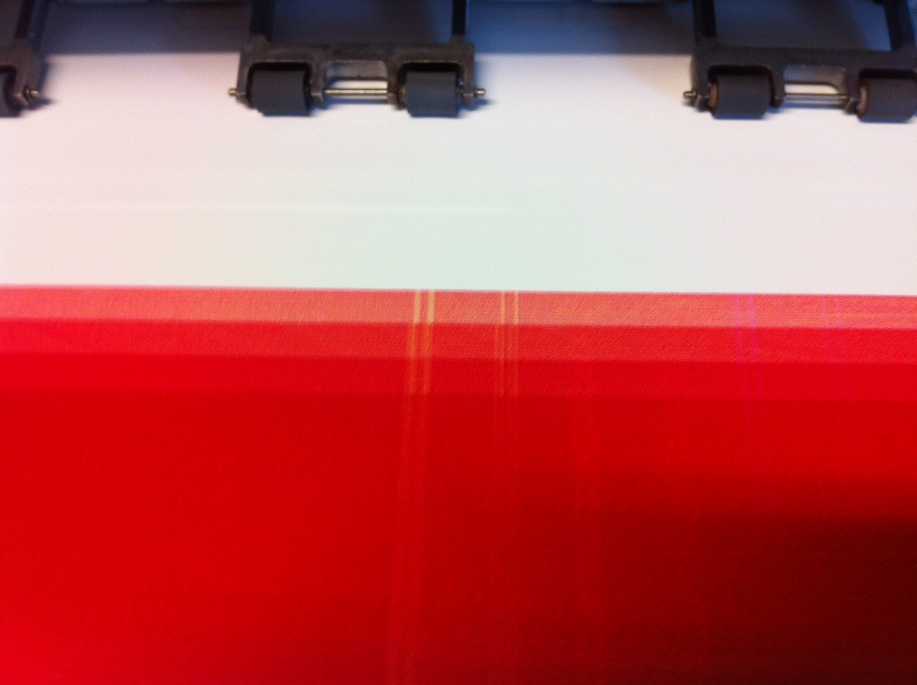

    I think I fixed the ink starvation problem. Now I am have a new problem with these cmy vertical lines (you can see the yellow lines better, but if you zoom in you see the other two colors). The weird thing is its only in that one spot. The rest of the print looks ok. It’s only on the left side of the print as you looking at machine and nowhere else. Is this from print head calibrations. If so, what part of the calibration part is out.

  • Josh Steenbergen
    March 14, 2013 at 9:23 pm
    Anybody know prob on second pic. Thanks
  • Stafford Cox
    March 20, 2013 at 11:04 pm
    Yep, probably encoder strip…..??
