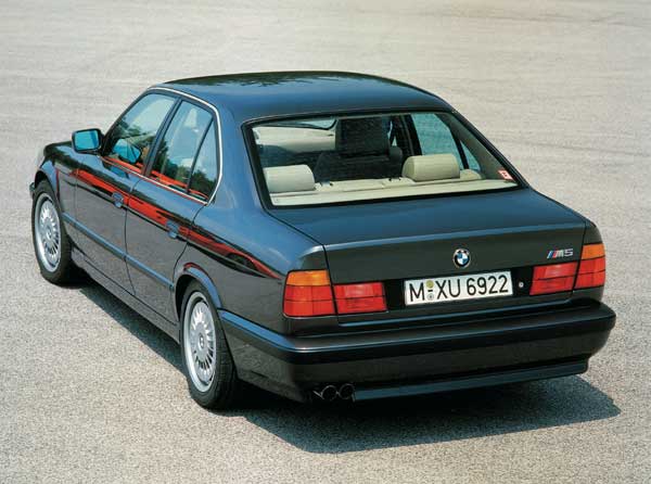

    E34 will be the tricky shape – & sorry, I have no solution, but it looks impossible to do without a join, & the narrowest part is the C pillar.
    Here’s a link of an E34 wrap on youtube, but conveniently, they don’t show much of the C pillar, but you can tell that they joined it a the top of the A & C pillars.
    http://www.youtube.com/watch?v=e5qTbPs2AHY
    Pic for others reference.
