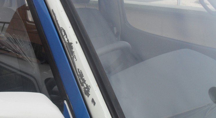

    It not only happens on shoddily re-sprayed vehicles. We just had a similar case on a FACTORY sprayjob.
    The van, a (ahem!) Chinese made nock-off of a Toyota ("Golden Dragon Bus Company :lol1: ) had the paint coming off all over.
    Since this is a short term wrap (on for 6 months) I used Avery MPI 3000 vinyl. (not air release type) The print is made nose -to-tail in one piece. The applicators pull the backing off the whole print, and lightly position against the sides of the van, then lift the print off to squeegee down properly. Even with the vinyl just barely touching the paint (no squeegee’ing yet) when the lifted it of large areas of paint came away….This happened on ALL the panels!
    The paint layer was paper thin – you can scratch it off with your finger nail where the vinyl lifted it off !! The paint on these "quality" chink products is so good, after only a few weeks at sea during transport, rust spots develop all over the bodywork.
    We called the client in, and showed him what happens. He was mad as hell, fortunately at himself for buying that piece of junk in the first place.
    What would happen if we remove the squeegeed vinyl after 6 months is going to cause a few giggles!

    October 26, 2010 at 4:28 pm
    Some pictures of the offending Chinese Van…
