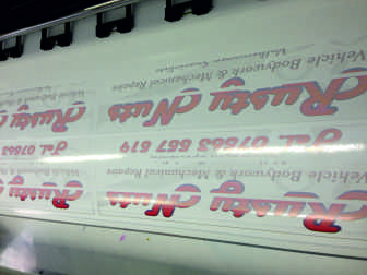

    When i turned the Mimaki JV3 on this morning i was greeted with this problem and ive now wasted the day fixing it !
    has anyone had this banding and loss of colour issue before? and if so how to correct please.

    thats the problem !!

    The picture isn’t too clear but from what I can see, it looks like a MASSIVE feed compensation value. Have you run the media comp setting (2 gray bars)? From local, press function and then keep pressing enter until it starts printing something. Post a picture up of what it looks like 😉

    cheers Stafford, i will give it a go in the morning and let you know what happens!. I had a error code 50 this morning so that might answer that? i cleaned the media sensor and encoder strip ut was getting worse as the day went on !

    Error 50 is definitely a media sensing error. More often than not, the media sensor has had a knock and the clips have broken off. You can replace it or do a repair with blue tack 😉
    I would also check that the lack strip in the gulley of theplaten is clean too. It picks up the media by scanning the media against that dark strip and as it’s often dusty, that where it fails.
